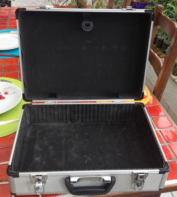

First of all find an old briefcase

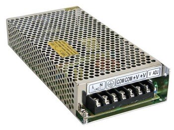

Then provide a unique switching power supply for
  • Raspberry
  • USB Hub
  • Breadboards
I find this one powerfull enough : 100 watts - 5 VCC

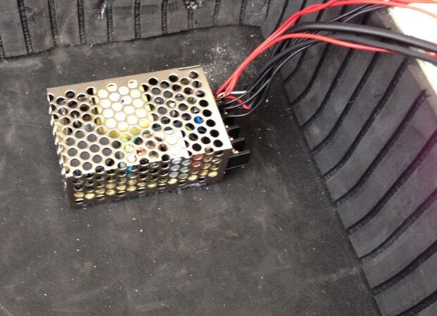

Here is the power mounted in the briefcase. All fasteners are made by scratches

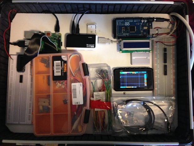

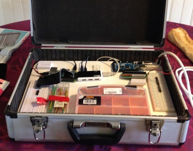

Here is the case layout with a double bottom to hide the cables and a unique on / off switch for both components.
I used the remaining space to put boxes for components, wires etc.
Icing on the cake, I can put a small portable oscilloscope in the box (or a multimeter)
Note that we need a keyboard and a mouse that fits in the box.
So we got a complete autonomous plug and play  prototyping system.
