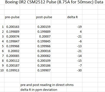

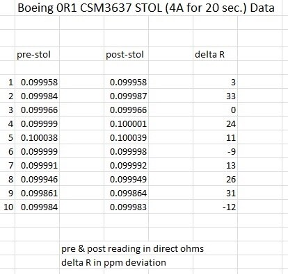

Pulse / Short Time Overload test of our ultra-high precision current sense surface mount resistors.
Extending performance beyond limits - CSM3637 @ 4A for 20 seconds (instead of 3A for 15 seconds) and tested the 0R2 CSM2512 @ 8.75A for 50 msec. (instead of 6A for 20 msec)
Essentially zero changes in the resistance values!image
