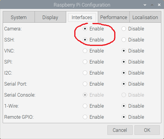

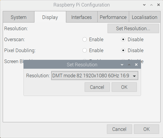

Change your settings
Use Raspberry Pi Configuration to enable the camera. You can also enable SSH if you want an easy way to control it remotely. Change your resulotion to what you need. 1920 x 1080 seems to work fine with the PYNQ-Z2 but apparently we'll be using lower (640 x 480?) in the workshops.

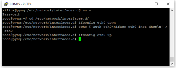

Strangely, the PYNQ-Z2 is set up to use a static IP of 192.168.2.99. I don't think anyone uses 192.168.2.x at home. I've usually seem 192.168.0.x or 192.168.1.x. Once the board boots up this makes it unreachable without lots of messing around with IP addresses. I initially changes my router to use a 255.255.252.0 subnet mask, but then found an easier way!
If you fire up the PYNQ-Z2 board with a USB cable and ethernet cable attached, a serial port will appear. Connect to this using your preferred serial terminal (115200 8-N-1) and you get a bash console. This should let us reconfigure the network. The official FAQ says you need to change /etc/dhcp/dhclient.conf but unfortunately this is incorrect. The file you actually need to modify (in Pynq 2.5 at least) is /etc/network/interfaces.d/eth0. In my case, all I wanted was for the PYNQ board to grab an appropriate IP address via DHCP. This is the original contents of /etc/network/interfaces.d/eth0:
auto eth0
iface eth0 inet dhcp
auto eth0:1
iface eth0:1 inet static
address 192.168.2.99
netmask 255.255.255.0
DHCP
What I needed it to be for the PYNQ board to use DHCP was just those first to lines, i.e.:
auto eth0
The easiest way to do this was to just overwrite the file - after taking a copy of it first of course. The first time I tried it using sudo was enough but when I retried for this guide, I seemed to need su first. No idea why. Anyway, this is what I did to change the PYNQ to use DHCP. To be honest I'd have thought DHCP would have been the simplest default option for most people.
Linux gurus may know an even easier way. Feel free to let me know out in the comments. You should now find that on startup your PYNQ-Z2 board grabs an IP address and all you need to to from here on is go to http://pynq:9090 as in the guide.
