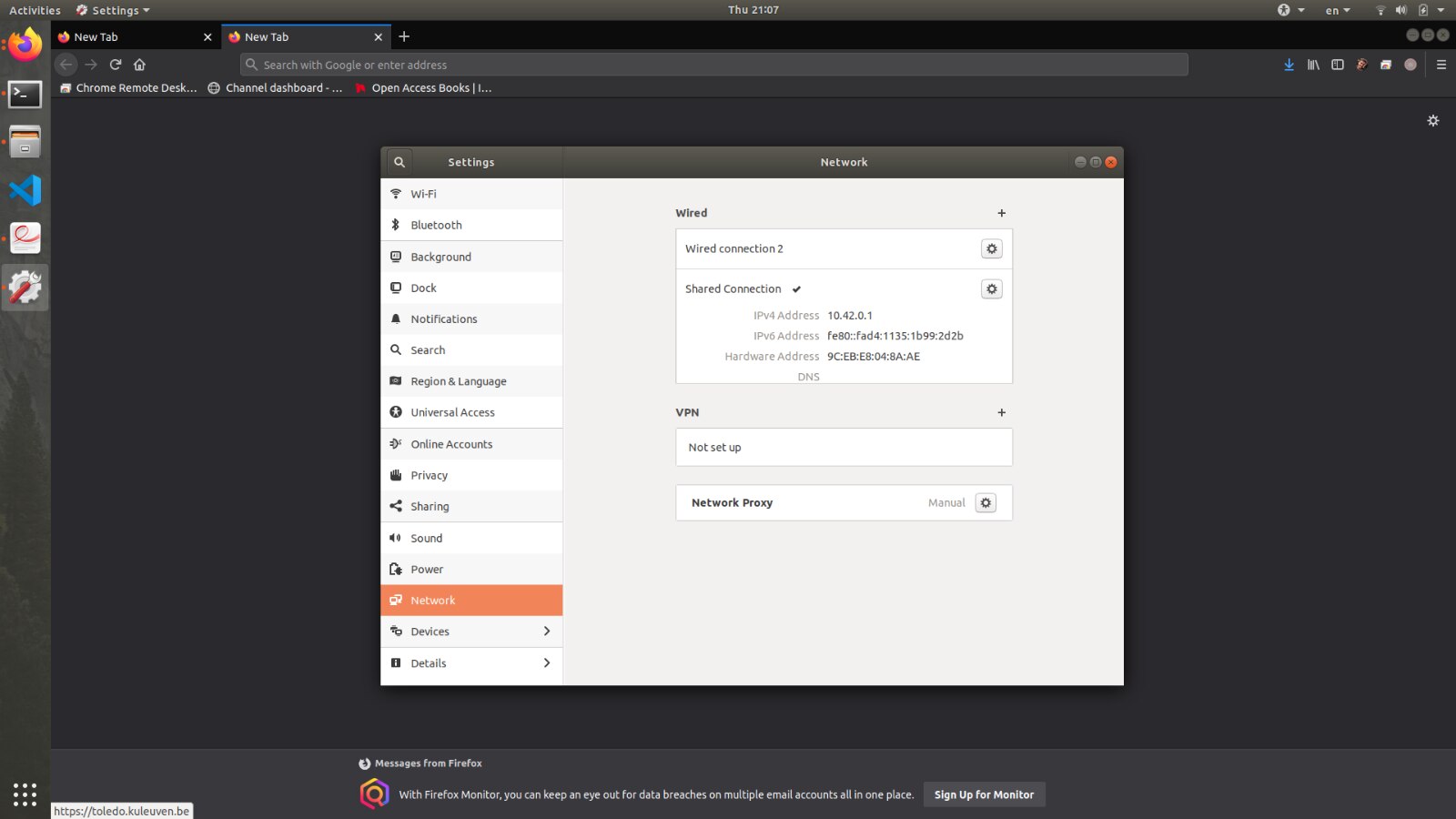

However, because the Ethernet link creates a new local network between the PYNQ-Z2 and your PC, it does not have a connection to your home WiFi and hence the Internet. Which is also reflected upon by the PYNQ documentation. That means that you have to perform some network address translation and port forwarding on your PC to act as a router for the PYNQ-Z2 (also referred to as bridging in this particular case to bridge Ethernet with WiFi). The easiest way to do it in Ubuntu is by creating another Ethernet network which you will configure as "Shared to other computers" by running in the terminal (ignore the $):
$ nm-connection-editor
This will open the connection manager. Click "+" to create new. In the new window, give it name, "Shared Connection" for example. Then click "IPv4 Settings" and in the drop-down select "Shared to other computers". Save and exit.
Ubuntu will perform all the necessary configurations for you and will run a DHCP server on that network, assigning you the IP address 10.42.0.1 (do not change it) and some random one within appropriate range to the connected PYNQ-Z2.

5. Shutdown the Jupyter notebooks kernel, change on your PC the wired connection to the previously made "Shared Connection" network
6. You can now browse to this recorded in the previous step IP address (10.42.0.192 in my case) and use it as explained in the lab text, but now you have access from PYNQ-Z2 to the global Internet via your Ethernet link to PC!
