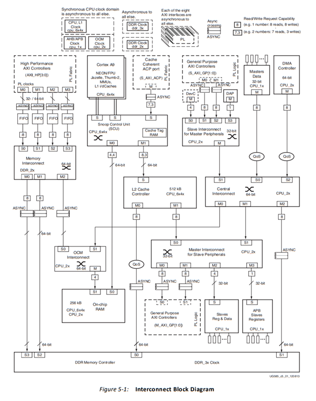

AXI is a point-to-point protocol for communicating between the processing system (PS) and the programable logic (PL) of the device. One side is set up as a master, the other a slave. In the ZYNQ device there are 9 AXI PS-PL interfaces:
  • 4x high performance (AXI_HP)
  • 1x cache-coherent (AXI_ACP)
  • 4x general purpose (AXI_GP)
and we can see seven of them with the master originating in the PL side here in the Xilinx UG585 documentation, upper left to upper right:
The two remaining AXI_GP interfaces which have the master originating in the PS side,  are shown lower centre and these are the ones we will be using in this blog.
AXI_GP consists of four general purpose ports conforming to the AXI 3 interface specification (two master ports and two slave ports) each with a 32bit data width. In the above diagram the master ports can be seen in the Master Interconnect for Slave Peripherals interconnect switch and they connect to General Purpose AXI Controllers in the PL Logic. They are referred to as M_AXI_GP0 and M_AXI_GP1 on the PS side and as we can see from the Xilinx UG585 documentation, they are mapped at the following address ranges:

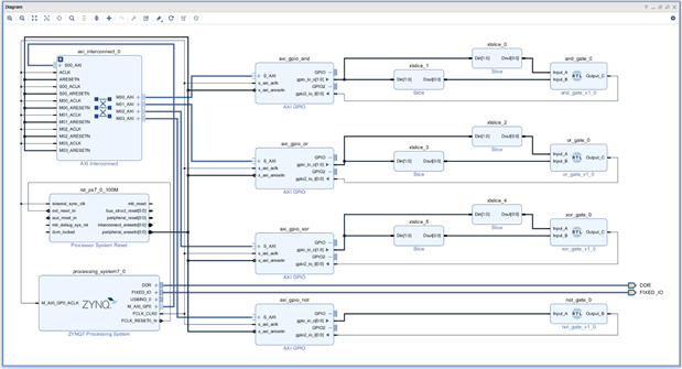

Multiple AXI GPIO controllers (AXI slaves) can be implemented in the FPGA fabric, and in this design four are used, one per logic gate. These will need to be connected to AXI masters in an intermediate AXI interconnect which then connects back to M_AXI_GP0.

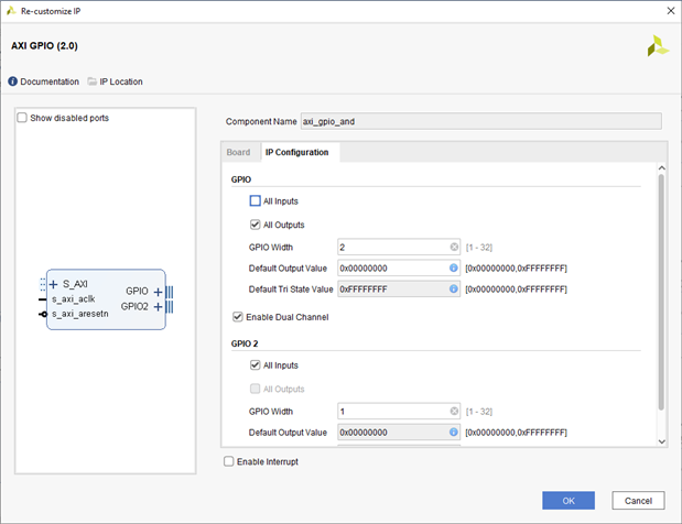

Each AXI GPIO controller has two channels, and often in examples only one of them is used for simplicity and/or demonstration purposes, however here we will use the channel 0 as a GPIO output to connect to the inputs of the logic gate and channel 1 as a GPIO input to connect to the output of the logic gate.
Here is the completed block design which will be turned into an overlay for use with the PYNQ framework:

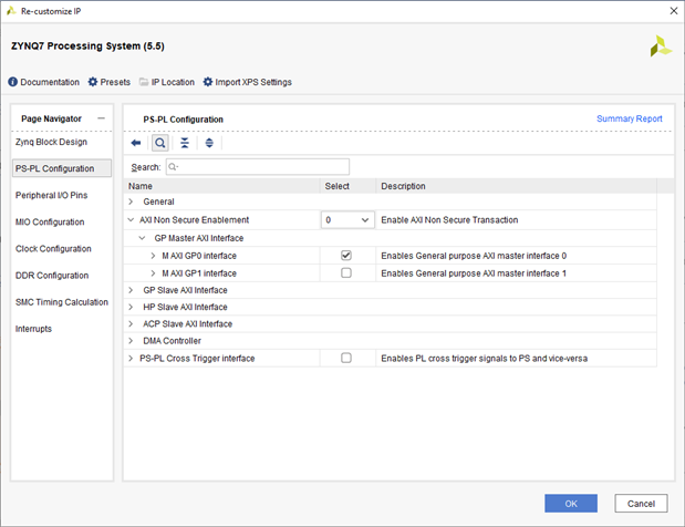

Starting with the ZYNQ7 Processing system we use the Master AXI GP0 output (M_AXI_GP0) to connect to the PL.
This needs to be enabled in the ZYNQ7 Processing System configuration.
M_AXI_GP1 interface should be left disabled as we aren't using it in this design.
As AXI is a point-to-point protocol and as we have four AXI GPIO controllers we must first use an AXI Interconnect to create four Master AXI ports, one for each controller. The AXI Interconnect also provides the necessary conversion to convert from the AXI3 protocol on the PS:
to AXI4Lite protocol on the AXI GPIO controller IP:
Each AXI GPIO controller needs its second channel enabling and its GPIO ports configuring.
The AND, OR and XOR GPIOs require GPIO setting to a 2bit wide output, and GPIO2 setting to a 1bit wide input.
The NOT GPIO requires GPIO setting to a 1bit wide output and GPIO2 setting to a 1bit wide input.

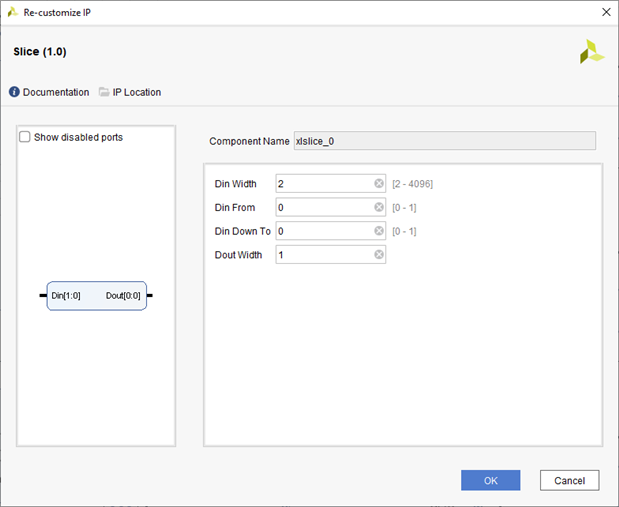

Slice blocks are then used to split the 2bit outputs into two separate 1bit outputs to be used with the 1bit wide inputs to the AND, OR, and XOR logic gates.
For logic gate Input A we will use bit 0 on the input:
and for logic gate Input B we will use bit 1 on the input:
The NOT gate does not require a slice block as it is already a 1bit output which can be directly connected to the 1bit input.
Concat blocks aren't required on the logic gate outputs this time as they are being connected to 1bit inputs on the AXI GPIO controller blocks.

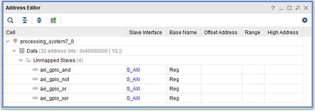

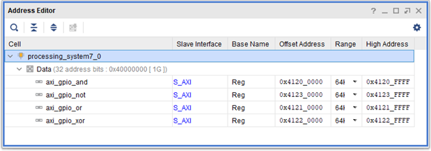

Before we can make use of the AXI GPIO controllers in the PS, they require their offset addresses configuring as by default they appear as Unmapped Slaves.
Addresses can be assigned automatically, but it is always worth checking that they fall within the correct range as per the documentation. For M_AXI_GP0 we need them to be within the address range of 0x4000_0000 to 0x7FFF_FFFF.

This completes the FPGA design and if it is all connected up correctly, then this will allow the input states of the four gates (LUTs) defined in the PL to be configured by Jupyter in the PS and the output states to be read all using the AXI GPIO interconnects.
The final steps required in Vivado were to Validate Design, Create HDL Wrapper, Run Synthesis & Implementation, and Generate the Bitstream. The resulting files were copied over onto the PYNQ-Z2 dev board ready to be loaded into the PYNQ framework as a custom overlay.

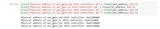

We can query the physical addresses for the AXI GPIO controllers from the IP dictionary
and_address = axi_gpio_design.ip_dict['axi_gpio_and']['phys_addr']
or_address = axi_gpio_design.ip_dict['axi_gpio_or']['phys_addr']
xor_address = axi_gpio_design.ip_dict['axi_gpio_xor']['phys_addr']
not_address = axi_gpio_design.ip_dict['axi_gpio_not']['phys_addr']
and print them out to check they match what is expected
print("Physical address of axi_gpio_and GPIO controller: 0x" + format(and_address,'02x'))
print("Physical address of axi_gpio_or GPIO controller: 0x" + format(or_address,'02x'))
print("Physical address of axi_gpio_xor GPIO controller: 0x" + format(xor_address,'02x'))
print("Physical address of axi_gpio_not GPIO controller: 0x" + format(not_address,'02x'))
Looks good !

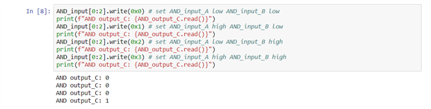

Test the AND gate
AND_input[0:2].write(0x0) # set AND_input_A low AND_input_B low
print(f"AND output_C: {AND_output_C.read()}")
AND_input[0:2].write(0x1) # set AND_input_A high AND_input_B low
AND_input[0:2].write(0x2) # set AND_input_A low AND_input_B high
AND_input[0:2].write(0x3) # set AND_input_A high AND_input_B high

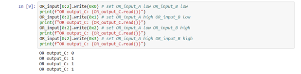

Test the OR gate
OR_input[0:2].write(0x0) # set OR_input_A low OR_input_B low
print(f"OR output_C: {OR_output_C.read()}")
OR_input[0:2].write(0x1) # set OR_input_A high OR_input_B low
OR_input[0:2].write(0x2) # set OR_input_A low OR_input_B high
OR_input[0:2].write(0x3) # set OR_input_A high OR_input_B high

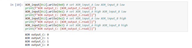

Test the XOR gate
XOR_input[0:2].write(0x0) # set XOR_input_A low XOR_input_B low
print(f"XOR output_C: {XOR_output_C.read()}")
XOR_input[0:2].write(0x1) # set XOR_input_A high XOR_input_B low
XOR_input[0:2].write(0x2) # set XOR_input_A low XOR_input_B high
XOR_input[0:2].write(0x3) # set XOR_input_A high XOR_input_B high

The outputs of these four gates would all appear to be behaving as expected. Success !
