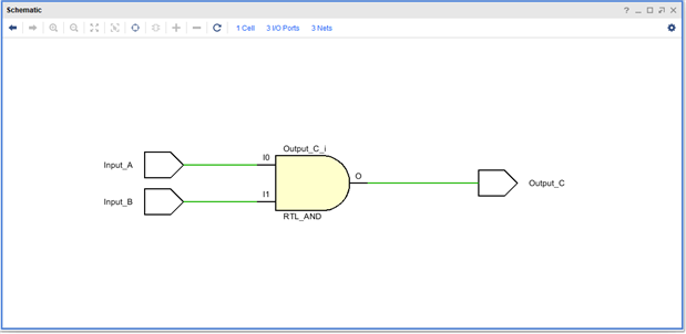

The first step was to get more familiar with GPIO within the PYNQ framework. I created some simple logic gates (AND, OR, XOR, NOT) in Verilog to simulate entry-level training content and turned then into reusable custom IP blocks to allow then to be used within the Xilinx Vivado tools block design alongside the ZYNQ IP required to create a PYNQ overlay. In the second workshop we had touched on this by using high level synthesis to recreate IP from another overlay but this would be my first attempt at creating a new Verilog design and using it with the PYNQ framework.
Starting the design in Vivado
First off I needed to create the logic gates to be used as basic training content. This was done using some Verilog.

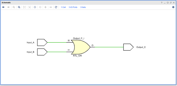

OR gate:
`timescale 1ns / 1ps
module or_gate(
    input Input_A,
    input Input_B,
    output Output_C
// Port definitions
// Description of the digital system
// Dataflow modelling
assign Output_C = Input_A | Input_B;
endmodule

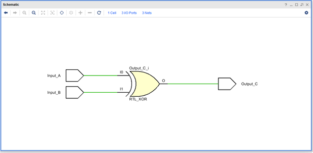

XOR gate:
module xor_gate(
    input Input_A,
    input Input_B,
    output Output_C
// Port definitions
assign Output_C = Input_A ^ Input_B;
endmodule

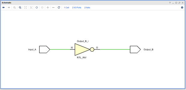

NOT gate:
module not_gate(
    input Input_A,
    output Output_B
// Port definitions
assign Output_B = ~ Input_A;
endmodule
The RTL schematics which Vivado produced all appeared to match what I was expecting. The next step was to get it connected to GPIO.

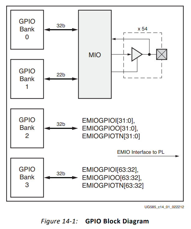

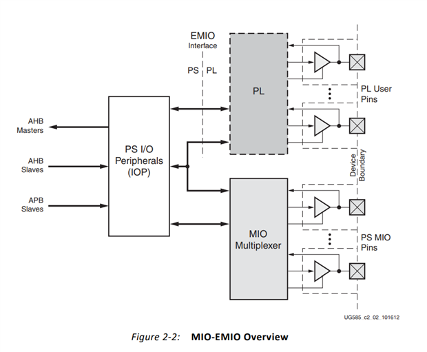

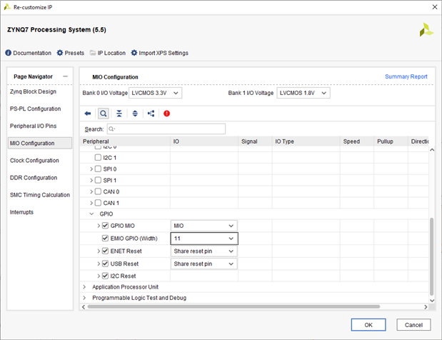

In order to connect the logic gates to the PYNQ framework I decided to use the PS GPIO of the ZYNQ device. The GPIO is divided between two banks of MIO and two banks of EMIO as shown in the Xilinx UG585 documentation:
The two EMIO banks provide the interface between the PS and PL, once again as shown in the Xilinx UG585 documentation:
The EMIO provides two 32bit bidirectional IO channels, however in this case I only required 7 outputs and 4 inputs so only used 11bits out of the 64bits available.

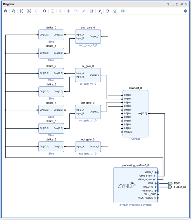

In Vivado Block Design the EMIO is presented on the ZYNQ7 Processing System IP as a multiple bit wide output port and a multiple bit wide input port of matching widths. In order to connect to the individual logic gates we need to be able to separate out and combine the individual bits to match the width of the those ports.

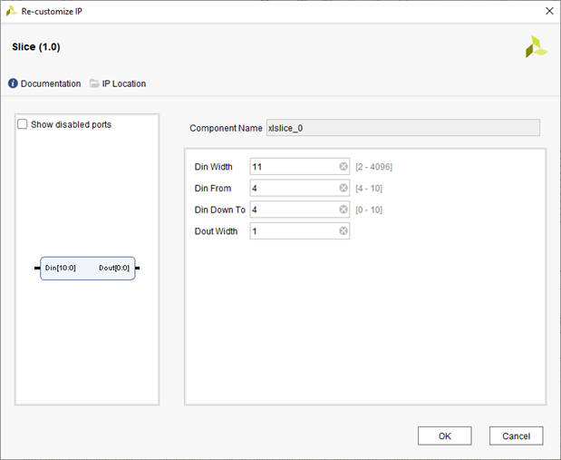

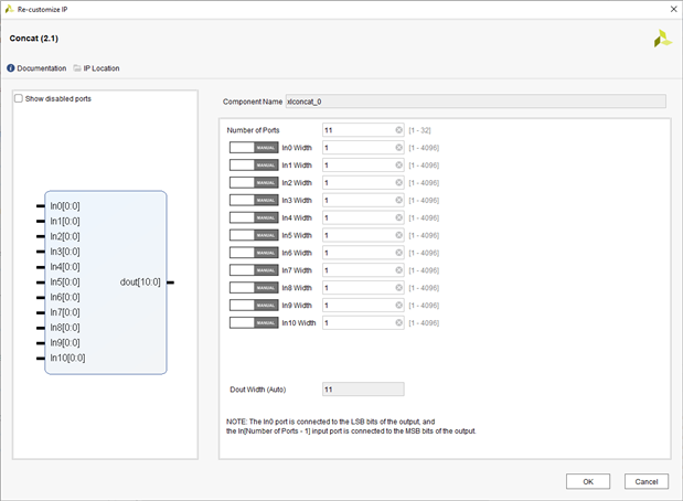

In this case I used the 'slice' and 'concat' IP blocks provided by Xilinx within Vivado.
Slice slices a range of bits from the input. In this case I'm slicing 7 single bits from GPIO_O 4 thru to GPIO_O 10. These will provide the 7 inputs to my logic gates. With slice, you can specify the start and end range but you can only create a single output port. The first slice is shown here which will be connected to Input_A of the AND gate:
Concat concatenates multiple ports into a single port. With concat you can specify multiple input ports but only a single output port. Vivado will complain if the width of the ports between the ZYNQ7 Processing System IP and the Concat IP don't match, and unfortunately unlike slice, you cannot specify the begin and end for the range of bits you want to use on that port. As the note in the dialog declares, In0 is always connected to the LSB of the output port, so by increasing the number of input ports from the 4 required up to 11 is a workaround allowing you to connect inputs to specific output port bits. In this case it doesn't really matter, as I started my inputs at GPIO_I 0 thru GPIO_I 3 and then continued my outputs starting from GPIO_O 4.
There are another 53 bits of EMIO available so this design could easily be expanded to accommodate 16 switches, 16 LED's, 7-seg displays etc as found on the various trainer boards.

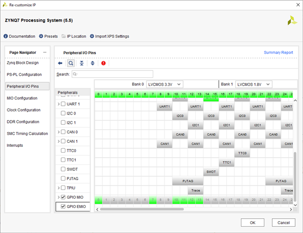

In order to connect Slice and Concat IP blocks to the ZYNQ7 Processing System IP GPIO ports, the EMIO peripheral I/O pin first has to be enabled:
and the EMIO GPIO (Width) needs to be set. In this case to 11bits wide.
This adds the connection port to the block diagram and allows connections to the EMIO GPIO.
The 7 inputs of the four custom logic gate IP blocks are connected to the outputs of the 7 Slice IP blocks and the 4 outputs of the four custom logic IP blocks are connected to 4 of the 11 input ports of the Concat IP block. The resulting diagram looks like this:
The GPIO_0 in the ZYNQ7 Processing system block relates to the newly enabled EMIO.
This completes the FPGA design and if it is all connected up correctly, then this will allow the input states of the four gates (LUTs) defined in the PL to be configured by Jupyter in the PS and the output states to be read using PS GPIO.

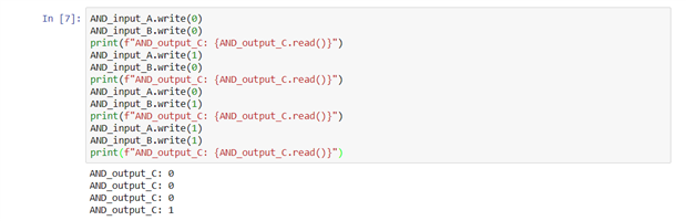

The PS GPIO is now all set up and we are finally able to test the function of each of the logic gates in the PL by setting their inputs and reading their output states.
AND gate
AND_input_A.write(0)
AND_input_B.write(0)
print(f"AND_output_C: {AND_output_C.read()}")
AND_input_A.write(1)
AND_input_B.write(1)

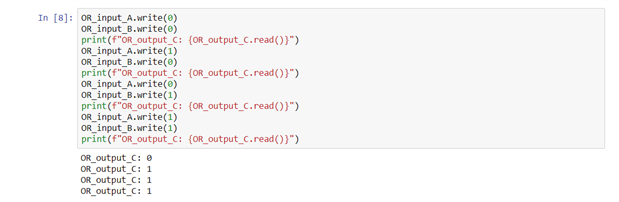

OR gate
OR_input_A.write(0)
OR_input_B.write(0)
print(f"OR_output_C: {OR_output_C.read()}")
OR_input_A.write(1)
OR_input_B.write(0)
OR_input_A.write(0)
OR_input_B.write(1)
OR_input_A.write(1)
OR_input_B.write(1)

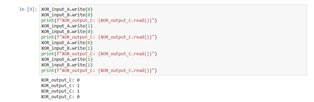

XOR gate
XOR_input_A.write(0)
XOR_input_B.write(0)
print(f"XOR_output_C: {XOR_output_C.read()}")
XOR_input_A.write(1)
XOR_input_B.write(1)

These logic gates all appear to be working as expected.
This completes the basic configuration and testing of EMIO GPIO on the PYNQ-Z2 dev board using the PYNQ framework.
