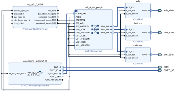

I found myself in this situation recently where I had been following along with a tutorial which was exploring the use of memory-mapped AXI GPIO on the PYNQ-Z2 development board. The PYNQ overlay being used included design elements for the push buttons, switches, and LEDs but not for the two RGB LEDs. The supplied block diagram confirmed this to be the case:
(original design from Xilinx PYNQ Workshop Session 4 https://github.com/Xilinx/PYNQ_Workshop/tree/master/Session_4  )

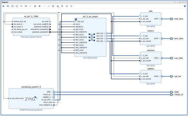

With my knowledge gained from the recent PYNQ-Z2 Embedded Vision Workshop, this turned out not to be a significant problem, as I decided to have a go at creating my own version of the overlay but with the additional AXI GPIO block for the RGB LEDs added and then to access it via memory-mapped registers using the PYNQ framework.
The resulting design in Vivado looked like this:
(enhanced design with additional AXI GPIO for the RGB LEDs added and routed to the on-board RGB LEDs)

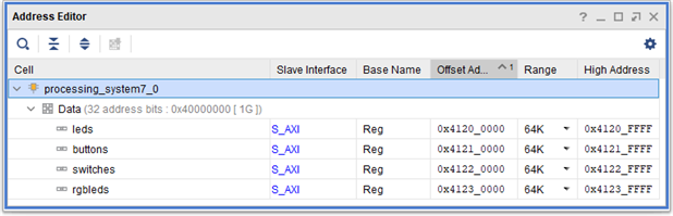

Creating the design from scratch in Vivado turned out to be really easy, with most of the 'wiring' being done via automation. I required to adjust a few settings as I wanted to try and keep the routing and addresses the same as the previous design which I was trying to enhance. However validation of the block diagram passed without problem, the HDL wrapper was created, and the bitstream generated.

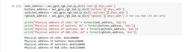

First we need to download the newly created overlay into the FPGA fabric:
Then we check that the address locations programmatically match what was assigned within the Vivado design:
It is looking good so far. The 'rgbleds' at address 0x41230000 is the newly added feature.

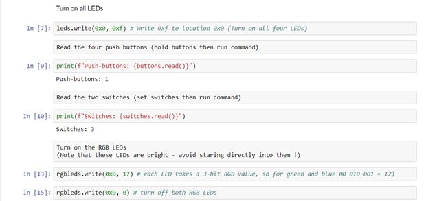

Now to import the MMIO class and create instances for each of the GPIO devices:
Remember to configure the tri-state registers at offset 0x4 to set the direction to input or output:
Finally try turning the LEDs and RGB LEDs on and reading the buttons and switches:
Everything works. Success !
The new overlay both replicates the functionality of the original overlay, plus it now adds access to the RGB LEDs.
