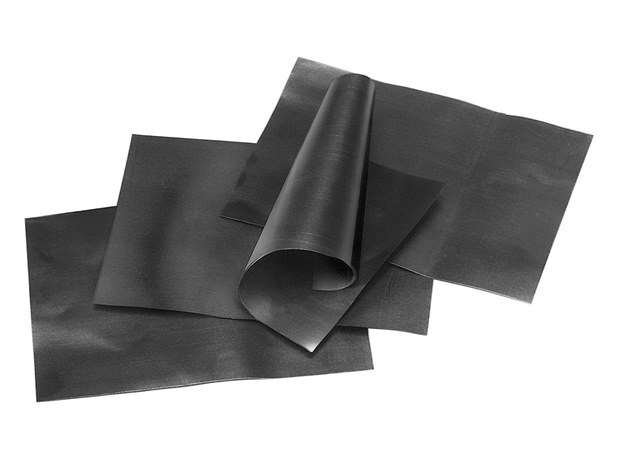

Panasonic has achieved the thermal management solution to today’s requirement for efficient heat diffusion in compact electronic devices. As designs require greater functionality and higher levels of performance in lighter, thinner, shorter and smaller devices, thermal management solutions become more challenging. For today’s extreme thermal management conditions, specify Panasonic’s Pyrolytic Graphic Sheet – PGS.
What is PGS ?
PGS is an ultra-thin, lightweight, graphite film with a thermal conductivity high enough to release and diffuse the heat generated by heat sources such as CPU’s, processors, power amplifiers and cameras. Developed by Panasonic engineers, this synthetically made material was named Pyrolytic Graphite Sheet or PGS. With a thermal conductivity up to four times greater than copper, PGS is extremely pliable and can be applied to heat-source shapes even in highdensity mounting situations.
Thermal Management Options
Ideal for providing thermal management / heat-spreading
in limited spaces or as supplemental heat-sink interface in addition to conventional means, PGS is light-weight, flexible and can even be cut into customizable shapes to protect any
electronic device.
Standard Pyrolytic Graphite Sheets provide excellent thermal conductivity that can withstand temperatures up to 400.
Features At-A-Glance
  • Thermal Conductivity: 700 to 1750 W/(m-K)
  • Offers thermal conductivity two to four times that of copper, three to seven timesthat of aluminum
  • Lightweight: specific gravity of 0.85 to 2.1 g/cm3
  • Flexible and easy to cut or trim
  • Withstands repeated bending
  • Low thermal resistance
  • RoHS directive compliant
