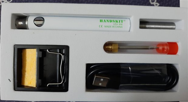

Before I test out these specs, let's look at the unboxing.
The iron comes in a nicely packed box with good quality graphics and feel. On the back side, it mentions the contents of the box.

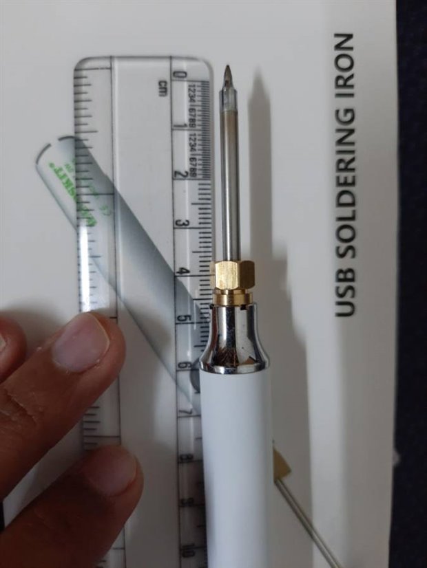

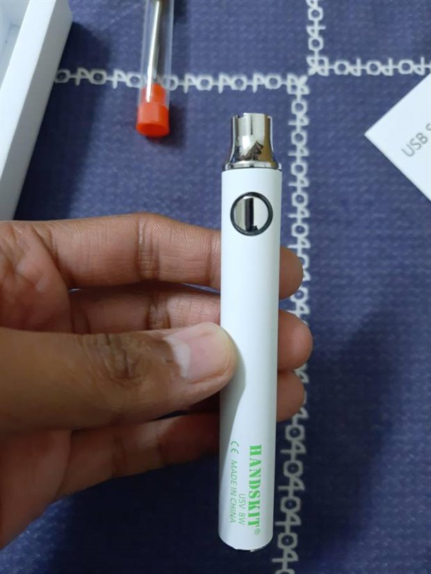

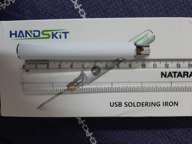

The iron is batteryless and feels very light weight. It is about 10.5 cms in length without the tip and the tip is about 4.5 cms so the soldering distance is really close to the PCB. The overall feel of the iron in hand is great. It has a rubbery coating which provides a good grip.  The box contains the main handle, a fine soldering tip (it's probably a 0.3 mm tip), a USB cable, small stand and sponge and a soldering wire.

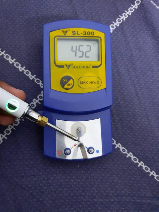

After pressing the button on the iron, the ring turns green. As per the specs the temperature should be around 330 - 350 C. So I used my soldering iron tip thermometer Soldering Iron Tip Thermometer Review  to check the temperature.
I have attached the results below
The iron took about 15 secs to reach a temperature that can melt lead free solder. I was quite surprised as for an inexpensive iron this is pretty good.

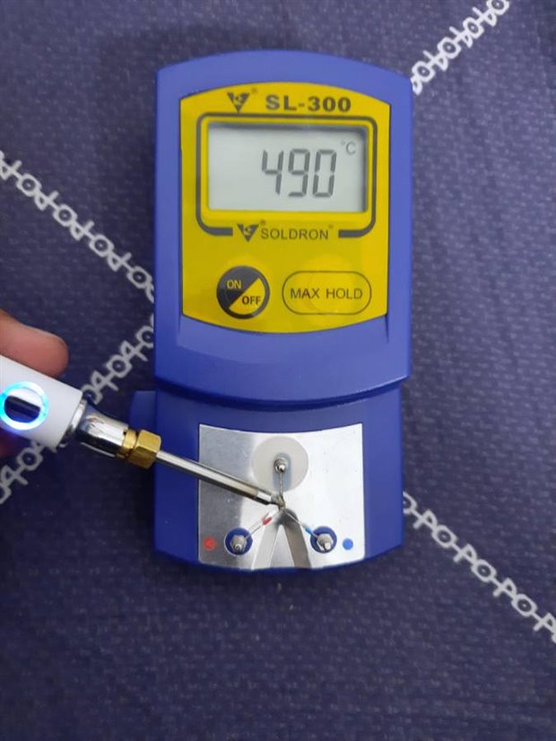

From the thermometer tests it seems that the iron is not calibrated properly. But the switch does change the temperature, so it's not just a marketing gimmick.

Green330 - 350452
Blue370 - 400490

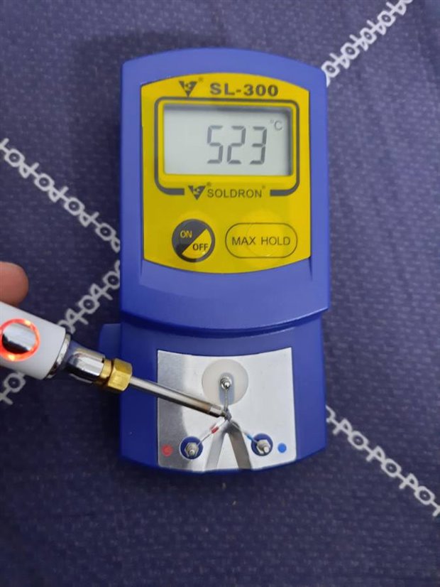

Red430 - 450523
I'm not sure if my thermometer is calibrated well or if the iron is really calibrated. But from my previous tests of the thermometer, I think it's the iron that's not calibrated.
After the tests, I'm skeptical about the use of this iron. As the temperature in the lowest mode is around 452, which can easily damage small SMD components.
