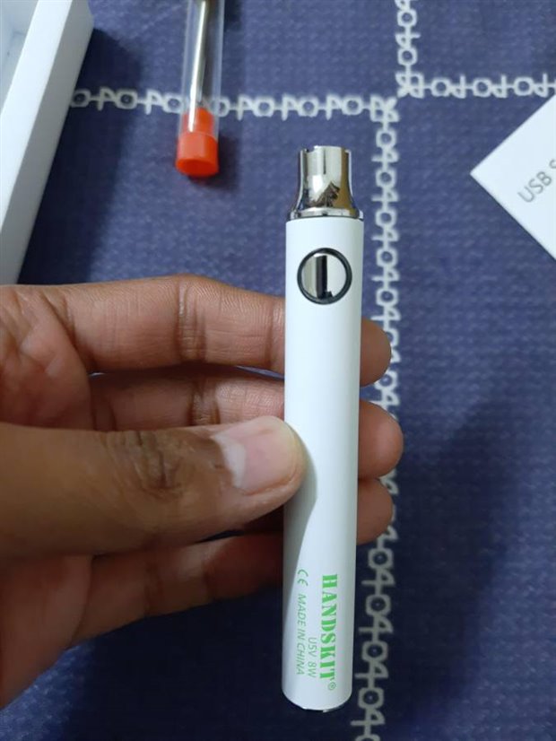

The iron comes in a nicely packed box with good quality graphics and feel. On the back side, it mentions the contents of the box.
The iron is batteryless and feels very light weight. It is about 10.5 cms in length without the tip and the tip is about 4.5 cms so the soldering distance is really close to the PCB. The overall feel of the iron in hand is great. It has a rubbery coating which provides a good grip.  The box contains the main handle, a fine soldering tip (it's probably a 0.3 mm tip), a USB cable, small stand and sponge and a soldering wire.
