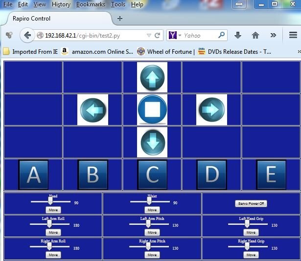

First the Html Browser approach.
You can control the robot with any device running a web browser.  Firefox and android work with the supplied program.
I haven't tested IPhone or IPad.  If you want to use Chrome or IE you can change the onchange event to onmouseup but then the phone and tablet do not work very well.
Remember to chmod the css and jpg files to 644 and the test2.py to 755.

The instructions for installing the required software on the RPi are included in this link:
Installing RaPiRo Web Control - eLinux.org
The pythons script name has changed to test2.py vice test.py.
Be sure and follow carefully the instructions on changing file permissions.
Use the icons and the test2.py script from the above link.
If you installed apache2 default settings the icons and css files go into the var/www directory and the test2.py goes into the usr/lib/cgi-bin directory.
