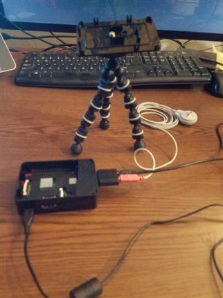

I built a baby monitor that streams video and audio to local browsers, and can see in the dark. It doesn't look creepy at all, see?
Hardware Ingredients
Raspberry Pi 2
Pi 2 Case
Pi Camera NoIR Ver. 2
Cheapo Labtec clip-on mic
USB sound card
USB WiFi dongle
Camera Stand (with grabby legs)

Finally, I was able to stream audio and video pretty clearly from any browser and device on my local network. I haven't set up any way to do this from outside my network because I don't want weirdos staring at my baby.
