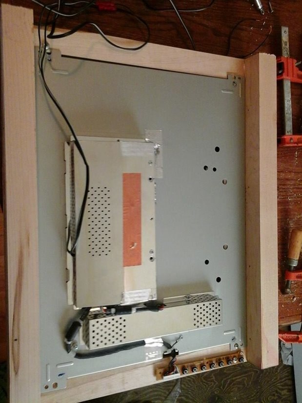

The frame is simple to build. I started by removing the LDC out of the monitor casing I used and Measured it. Using a miter box I cut the 45's needed to create a frame. I used a nail gun to secure the corners with 1 1/4 inch brads.image
This is just the Back of the Monitor Notice the 4 metal tabs I used to secure the LCD screen to the frame.
This photo shows the back of the monitor the Raspberry Pi and the HDMI to VGA adapter. I used a wood screw to attach the monitor control panel to the back side of the frame out of site. I have not mounted the Raspberry Pi yet because it will require an insulator between the back of the monitor and the PC board to avoid it shorting out.
