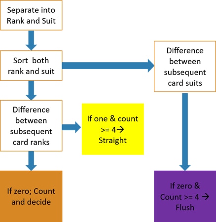

After identifying cards, the poker player is ready to identify hands. The flowchart in Figure 4 describes how this is implemented in MATLAB.
Fig 4: Flowchart to identify hands
Let’s use the example hands in the table below to better understand this flowchart. Note that the final 5 cards in each hand are community cards that are shared among all players.
After identifying cards and hands, the Poker Player is ready to place bets!  The betting algorithm is very simple and based solely on what the identified hand is.  It starts at 1 USD for a Highcard and increases by 1 USD for each subsequent ranked hand up to 10 USD for a Royal flush. The algorithm only makes bets on the complete hand, but it could certainly be updated and expanded.
