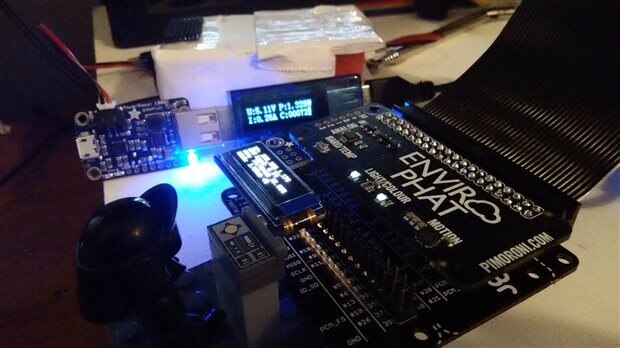

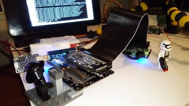

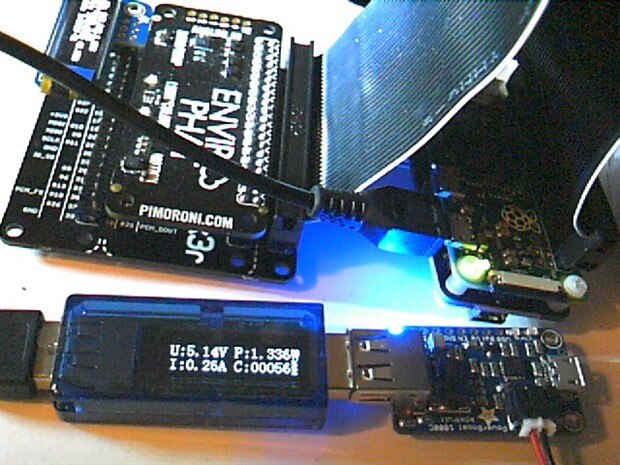

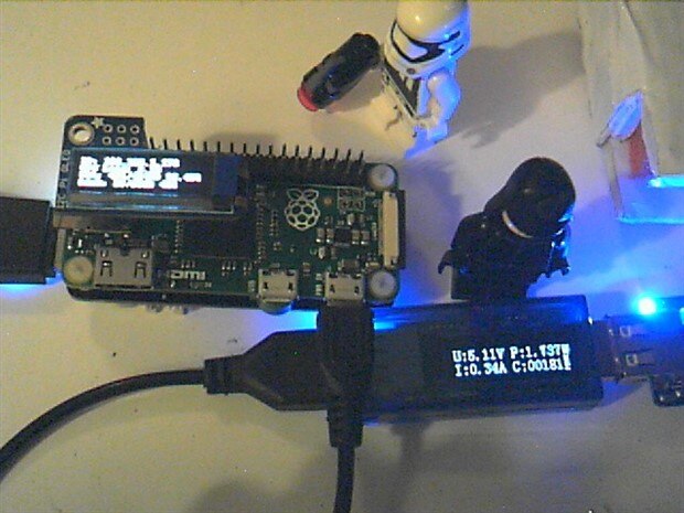

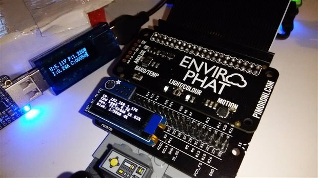

I recently purchased the Pimoroni EnviroPHAT and Adafruit PiOLED display for use with the Raspberry Pi Zero v1.3. I currently have the EnviroPHAT and PiOLED display connected to the RPi Zero and the Zero4U 4 Port USB Hub with the Pimoroni Mini Black Hat Hacker. Here are a few images of everything connected. I access the RPi remotely with SSH via WiFi. In the captured images I have the RPi Zero powered with the Adafruit PowerBoost 1000C and LiPo battery. There is also a USB Voltage Meter with OLED Display to monitor the power consumption.
These images and video were captured with a Xbox 360 Live Vision Camera I found at a used video game shop. I will explain in another post how to configure a Raspberry Pi 3 for use  with this specific Microsoft Live Vision Camera.
           With only the PiOLED, Zero4U, and Wifi Dongle connected to the RPi Zero
        And now with the EnviroPHAT, PiOLED, and Mini Black Hat Hack3r with moderate cpu usage during apt-get update && upgrade

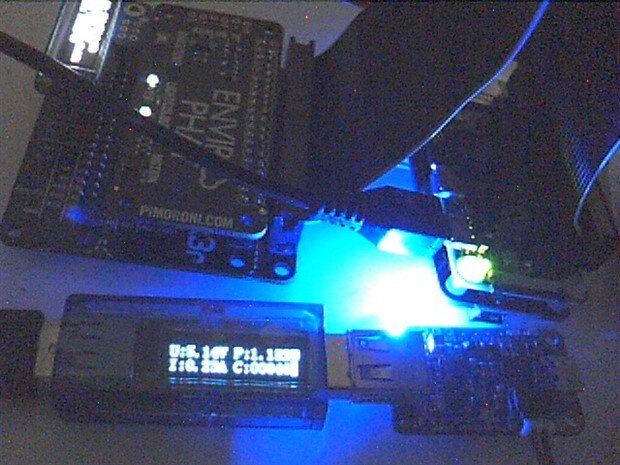

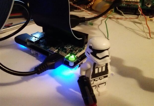

        Let's see those LEDs ! Show me the OLED!!
                               * Legos not included

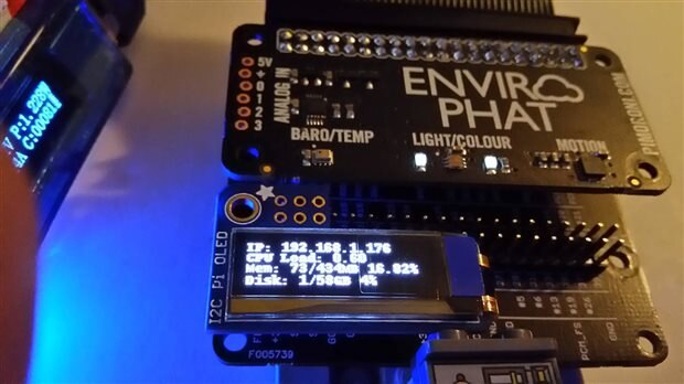

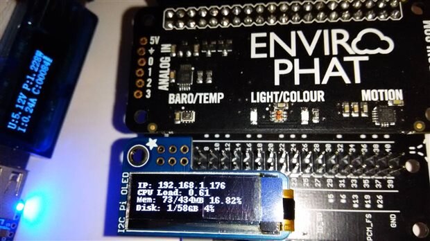

Let's have a closer look at the Adafruit PiOLED  display and the Pimoroni EnviroPHAT under better photographic conditions.
The Raspberry Pi 3 and Raspberry Pi Foundation 7" Touchscreen in a SmartiPi Case is my favorite. By using SSH we can update, upgrade and install necessary software with the Wifi USB Dongle. Important note, purchase Wifi USB Dongle from source that has confirmed the dongle is compatible with Raspbian.
Installing the Zero4U 4-Port Hub is very simple. It attaches to the RPi Zero with included 4 poly screws,spacers, and nuts. The Zero4U is powered via 4 gold pogo pins that contact with PP1 and PP6 for power, and PP22 and PP23 contact pinouts located on the bottom side of the Pi Zero. When the RPi Zero W was released, the makers of the Zero4U released an important hardware update which is the of the addition of a special ferrite ring to protect the PP22 and PP23  connected data carrying pogo pins from unwanted RF interference. This specific ferrite ring has been made available for purchase by the manufacturer for customers who purchased the Zero4U before the Pi Zero W was released.
The Pimoroni Mini Black HAT Hack3r GPIO Breakout Board is very helpful in testing multiple Pi Zero HATs as long as there are no conflicts in pin usage.

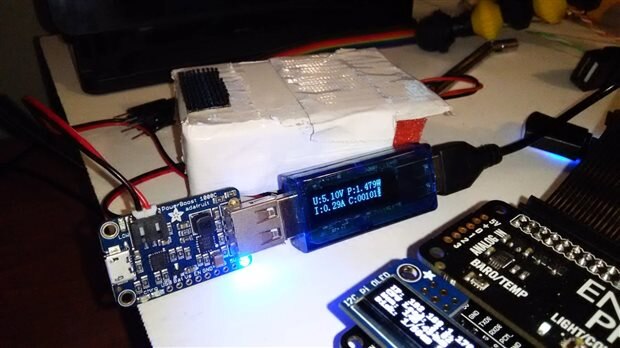

Power is supplied with the Adafruit PowerBoost 1000C and a 3.7v 2500 mAh Lithium Ion Polymer Battery Pack in a protective case made from foam board, recycled foam packing material and Duck Tape.
Here is a nice close up of the new Adafruit PiOLED with its tiny yet highly visible OLED display. I have not removed the protective film yet.
The Pi OLED retains visability and clearity in various lighting conditions. The Dual RGB LEDS of the Pimoroni EnviroPHAT become visible after I decrease the amount of ambient light in my office.
