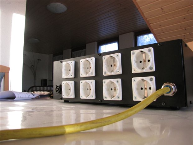

Then I saw my 20 year old "PowerManager" under my screen. It's a slim metal chassis with with a couple of AC outlets in the back and a couple of switches in the front to control them.
Looks like this
And I thought I should bring this (or the adaption of the idea) into 2k14.

after the hardware worked fine, I've built it into a 19" 3HE Case.
The AC supply cable, a RJ45 feedthrough connector for the network and the 8 switched AC outlets in the back.
8 Status indicator LEDs, an USB feedthrough connector and the shutdown/restart switch in the front
And all the electronics on the inside.
It became quite full inside.
