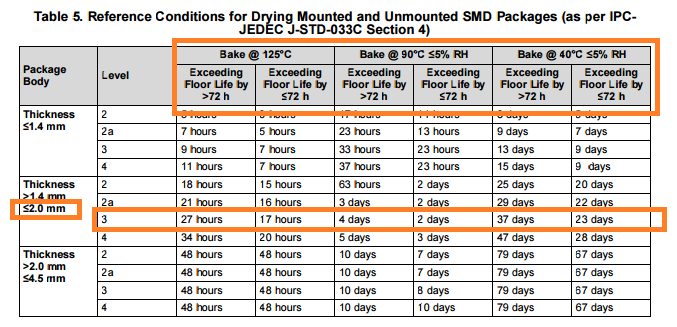

From the datasheet:
13.1 Package Information
The LMG5200 device package is rated as a MSL3 package (Moisture Sensitivity Level 3). Please refer to
application report SNOA550 for specific handling and process recommendations of a MSL3 package.
If we than check that report (our package is MLS3, 2mm thick), we're in for a long baking time.
I didn't bake it that long.
I used my microwave/combi oven - in the non-microwave mode - at approx 120° (all temperatures in Celsius) during 4 hours.
And I crossed my fingers.

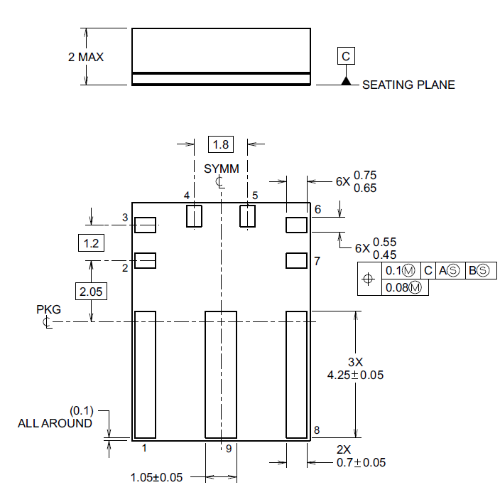

That wasn't really easy because you don't see the pads, and the PCB didn't have an outline drawing for the chip.
So I placed the IC where I thought it would cover the right pads with the right pins, and pulled out the hot air nossle again.

    I am presuming you needed to bake these because they were not in a hermetically sealed bag? One of the more interesting things at element14 Distribution at Leeds was the attention to detail for moisture…

    I saved energy by not baking it for 17 hours image
  • clem57
    clem57 over 10 years ago in reply to Jan Cumps
    That would have ruined a Raspberry Pi (either one)
    Jan Cumps over 10 years ago in reply to clem57
    I only baked the new IC in isolation as a preparation step before soldering it with hot air.
    TI proposed to pre-bake them for me before shipment and bag them as indicated by mcb1 . I told them I'd do the baking myself just before using the ICs. And that's what I did image.

    My own choice, mudz, in the hope to learn something - and I did.
    Also, these ICs don't come from a mass production batch - this is technology preview material. Someone from the fab would have to bake them for me.
    They kindly offered to do that, but I asked to send unbaked ones.
