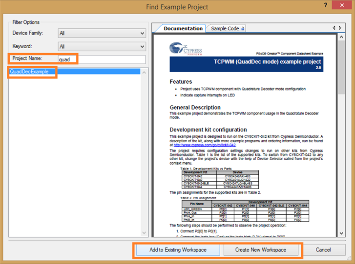

The Cypress PSoC Creator (their IDE) comes with a neat Quadrature Decoding example. It doesn't even need a rotary (or other) encoder. It generates the signals using the on board PWM modules.
I took it as a start, but replaced the on-chip generated signals with the real hardware encoder encoder outputs.
In my code, I added some instructions to read the decoder counter value. That's the data that I'm really after.
Because my needs are so close to that example, I started off with that:
I searched for a Quadrature example, and loaded it to the IDE. You can choose your favorite one out of the two create buttons.

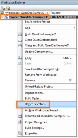

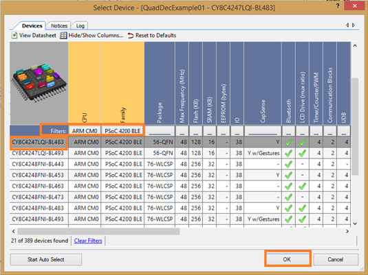

Once the project is created, take care that you select the right device.

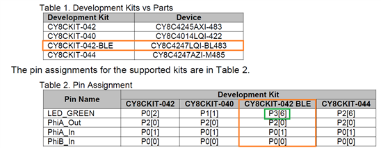

I found the right device name in the Quick Start leaflet of my dev kit.

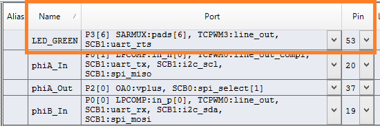

I then adapted the routing so that it fits my boards layout. The PDF file that's loaded in your IDE when you create the project has good info on that:
I kept the assignments for encoder PIN A and Pin B. I had to change the green LED assignment to the green pin of the RGB LED mounted on my kit.
Content from the QuadDecExample documentation.
That LED is the only on-board route to change. In the next section I'll describe the external connections. But as mentioned above, I haven't altered them.

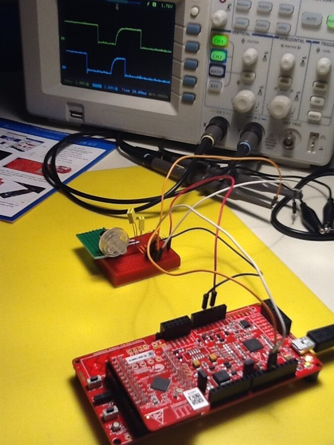

Wiring the Hardware
Look back at my first post to check how to components are wired up.
Then connect the encoder with the board.
Ground to Ground, 3.3V to 3.3V,
PINA to P0[1], PINB to p0[0].
Connect the kit, start the debugger and check if the execution breaks after a few turns left or right.
