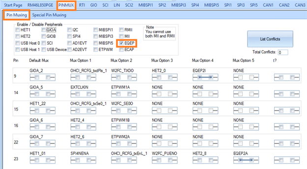

In HALCoGen, you have to configure the eQEP module.
Take care that you set the eQEP pins active in the pin multiplexing tab.
On the eQEP tab, we configure the peripheral.
That's 90% of the work done. Generate the code and switch to Code Composer Studio to write the C code.
