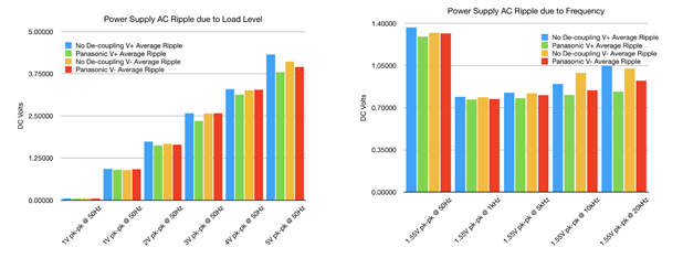

The average voltage for both the positive and negative rails is slightly higher without the de-coupling capacitors installed. For the positive rail, both DC fluctuation and AC ripple are significantly lower when the de-coupling capacitor is installed. This would be expected. The same trend is not seen for the negative rail, where only the AC ripple is seen to be lower with a de-coupling capacitor installed.
Looking ore closely at the DC Fluctuation;
As the load is increased in the lefthand plot, the fluctuation remains relatively constant up to the 3V input, around 1.8A output. After this the 220uF capacitor starts to have an effect and shows a lower fluctuation level. At 5V input, the negative rail shows the same level of fluctuation with or without the capacitor.
The righthand plot shows the fluctuation as the frequency is increased. The results are a little sporadic, with the fluctuation on the negative rail generally lowest without a de-coupling capacitor installed. At the highest frequency of 20kHz, the fluctuation is reduced with the 220uF capacitor installed, but this is the only result that really matches expectations.
The same set of test are then completed whilst measuring AC ripple.
The effects on load change are not as apparent as they were for the DC fluctuation, with the majority of the readings similar with or without a capacitor installed. At the highest load, about 3A output, the 220uF capacitor is starting to have an effect, more on the positive rail than the negative.
The plot for the frequency changes, shows better performance with a 220uF capacitor installed at the 10kHz and 20kHz frequencies, with no real differences seen at the lower frequencies.
Comparing the gain of the amplifier, it can be seen that a slightly lower average gain is seen when a de-coupling capacitor is installed. However, there is much less deviation in gain across the range of tests, when the capacitor is installed. The minimum gain seen is the same for both sets of tests and in actual fact the same 4V Input tests shows the lowest gain of 1.965 with or without a capacitor. With a capacitor installed, the maximum gain only ever reaches 2.020 for the 2V input test, which is different when no de-coupling capacitor is fitted than has the highest gain of 2.068 at the 5V input test, which represents the maximum load on the amplifier.

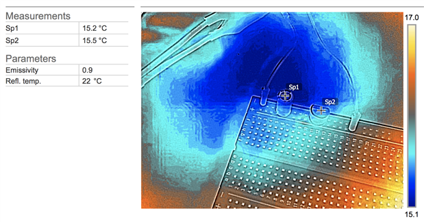

    I have taken a couple of snapshots with the thermal camera with a polymer and electrolytic capacitor hooked up to a DC supply of about 9V. The first picture is a at more of angle to the capacitors and the temperatures come out at around 15 Deg C.
    The second picture I took right above the capacitors and the temperature comes out 5 degrees higher.
    On both occasions, the polymer and electrolytic are around the same temperature. The second picture is closer to the ambient temperatures at the time.
    I also plotted the current of reach capacitor from initial switch on to 90 seconds after.
    You can see the electrolytic settles to a much lower current than the polymer capacitor, dropping below 1uA where as the polymer dropped down to about 8uA.
