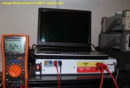

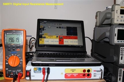

The Megger SMRT1 unit was the next to be tested. The manufacturer does not provide much information on the digital input. It does have the ability to work with either voltage present or voltage free contact on the relay with an input voltage between 5 and 300V AC or DC. I decided to try and measure the input resistance of the SMRT1 whilst it was energised with a multimeter set to ohms range. To do this the digital input of the SMRT1 needs to be configured to respond to a voltage applied to it and not its default state of a lot free contact when it outputs 15V to detect the contact closure.
The digital input resistance measured with the ohmmeter was 19.6kOhms. A second check was made by supplying 5V into the digital input which gave a current of 1.97mA supplied into the SMRT1.

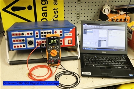

A similar set of tests were carried out on the other test set available to me.
This required a much lower input current of 10uA to enable the input at 5V.
Both these test sets should therefore be able to be driven by a TTL output. However, I do have one small concern. I did note during the tests that both units default to volt free contact configuration when first switched on. The SMRT unit puts out 15V and the CMC 356 puts out 8V. Both these voltage levels would cause damage to a TTL output.

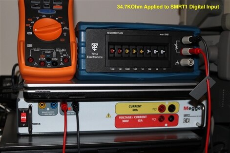

    Many thanks Gene, I have had another little play with the SMRT unit and it will see anything up to 34.7kOhm as a shorted input, so looks as though that the MOSFET methodology will not be too onerous on…

    I have had another little play with the SMRT unit and it will see anything up to 34.7kOhm as a shorted input, so looks as though that the MOSFET methodology will not be too onerous on the supply current. I do have to do the same test on the Omicron yet. I may be able to keep the supply voltage as 3.3V and not use a boost circuit.
