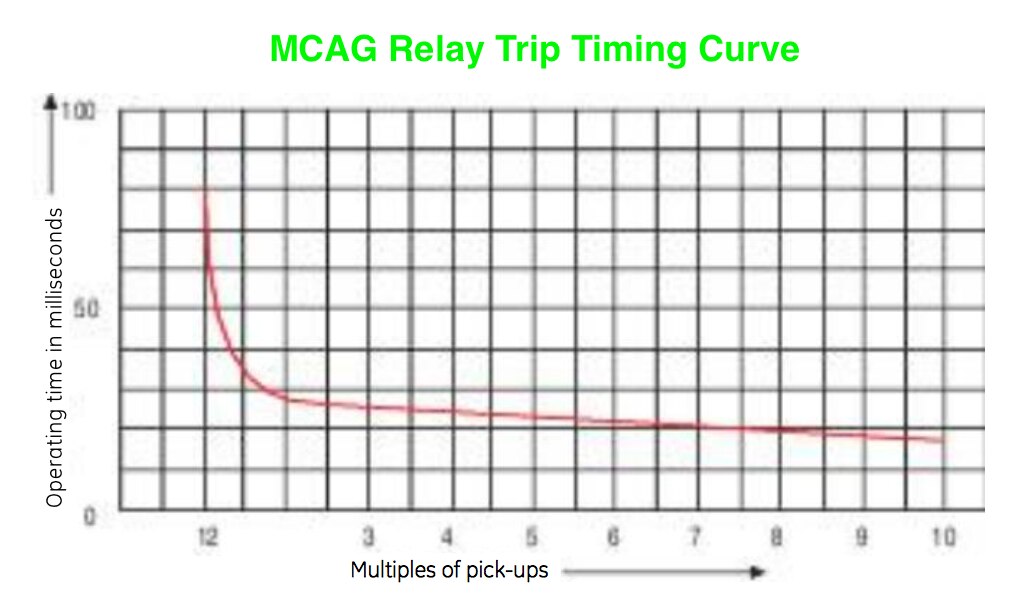

The manufacturer of the relay will provide specifications for the operation of the relay. Pickup currents are usually given as a +/- tolerance, for this particular relay it is -0% to +10%. Tripping times are usually given on a curve at multiples of current. Some software packages can trace these curves and regenerate them within the package to allow for automatic test point selection. However, I do not have that facility with the Megger package, so I read them off and enter them manually into the settings in the test form.
From the curve above, I can read off that at 5x the pickup, the trip time should be around 23ms and at 10x the pickup it should be around 18ms. This calls for accurate test apparatus as deviation of the test current injected will have an equal effect on the result as a poor timing function would.

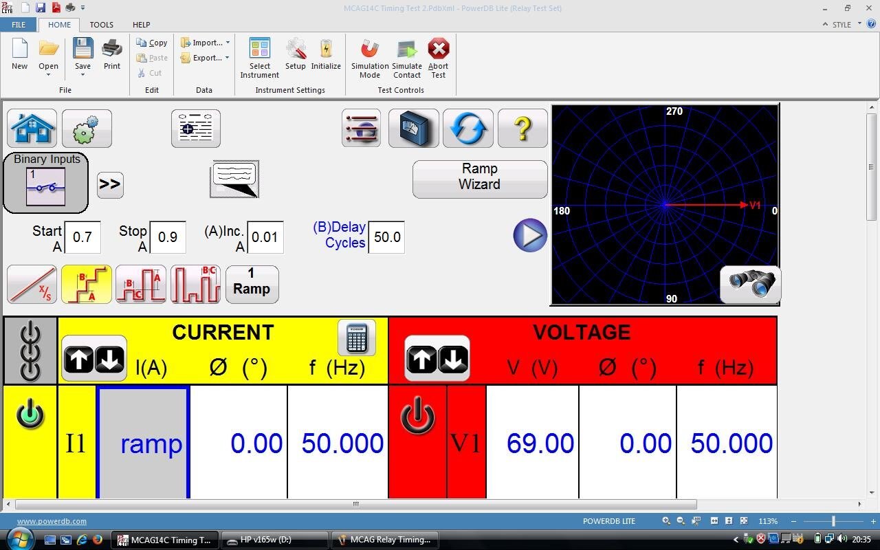

For the pickup current a ramp test is utilised where the start and stop points of the ramp are entered along with a step increase value and step interval time. For this particular relay, the pickup setting plug is set to 0.75A and the manufacturer specifies a tolerance of 0% to +10%. Therefore the ramp was set by the software automatically to start at 0.575A to 0.925A based on the data entered for the relay.
As there is no model for this particular relay within the software package, the timing points are chosen manually within the timing test window. The software will then plot these points onto the graph along with the minimum and maximum times expected. The video below lasts 1 minute 30 seconds and briefly covers the pickup and timing tests.
The screen shot below is of the manual set up for the pickup current test. I have selected a step ramp test, set to start at 0.7A and stop at 0.9A with a 0.01A step increase every second (50 cycles). This test would then be initiated by the 'play' button and would run until the relay trips and stops the test or the stop current is reached, whichever comes first.

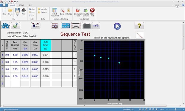

Below is the test and results screen for the timing tests. The timing points are entered as multiples of pickup current. As this test is manual, the minimum and maximum permissible times are entered into the columns during the set up. The software then selects the current to inject, identified in the second column, and records the time after each test in the final column. You can see that the resolution on the timing results is 1ms.
The results will be saved to a report module built into the software that can be printed out to provide a record of the inspection and test of the relay.
