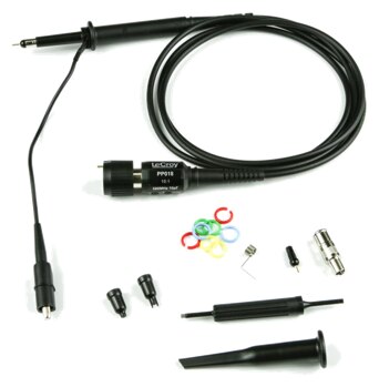

Figure 1: The 10x passive probe becomes a better measurement tool when we understand its limitations
The probe that every oscilloscope user is likely to be familiar with is the classic 10X passive probe (Figure 1), mainly because a pair of them comes with every oscilloscope. What's going on inside those things, anyway? In taking some time to examine the 10X passive probe closely, we can better understand its limitations.
The first thing to think about in the 10X passive probe is its mechanical interface: the tips. Three commonly used tips are the mini-grabber clip, short-return clip, and coaxial BNC. In the case of the former, be aware that the whole spring-loaded part pulls off leaving the signal pin exposed. The short-return clip is handy at times when a very short return path is important to a measurement vs. the roughly 3-inch lead on the mini-grabber device. The coaxial BNC attachment lets you attach the probe directly to a female BNC receptacle when such connectors are found on the DUT.
