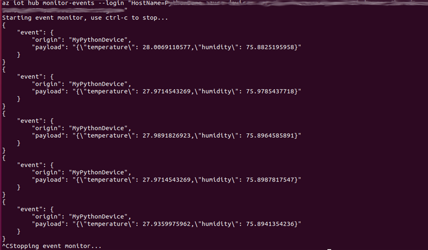

Monitoring Azure IoT Hub Events
With the telemetry messages now sent to the IoT Hub, use the Azure CLI to monitory the reported events using the command
az iot hub monitor-events --login "<<Connection String>>”
for example:
