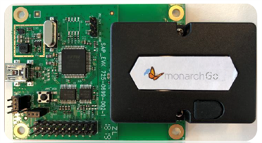

The Sequans Monarch Module is a LTE-M cellular modem that comes in two styles; one has GPS integrated, and one does not.  Both starter kits are available for purchased from Avnet using the following links:
https://www.avnet.com/wps/portal/us/products/new-product-introductions/npi/sequans-monarch-go
Using the Monarch Module in an IoT solution allows easy addition of Cellular communications capabilities--great for remote placement of sensors. This Blog discusses the setup of the Monarch-GO Module and utilizing it with AT commands over a serial connection.  I have posted an example Python script (at https://github.com/Avnet/sequans_python ) that implements a typical HTTP/HTTPS and MQTT connection

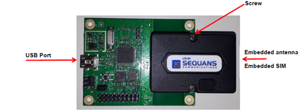

The Sequans Monarch-Go Module comes configured to use the Verizon cellular network.  To begin, ensure the Verizon SIM card is installed properly by removing the module from the PCB (two screws holding the module to the PCB board) and accessing the SIM card via the access door:
With the SIM card installation verified, connect the module to a PC using the serial port on the PCB to allow communications with a connected computer.  It is necessary to use a Serial Terminal program such as minicom or Putty when communicating with the module.
Once the mini-USB cable in connected, the Monarch-Go module and should automatically connect.  On a Windows PC the drivers will be auto-installed, on a Linux PC the connection is made as VCP ports (usually identified as /dev/ttyUSBx).   In total, there are 4 ports enabled by the module but only UART 1 is utilized:

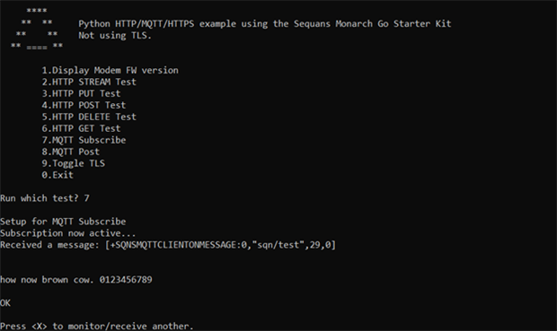

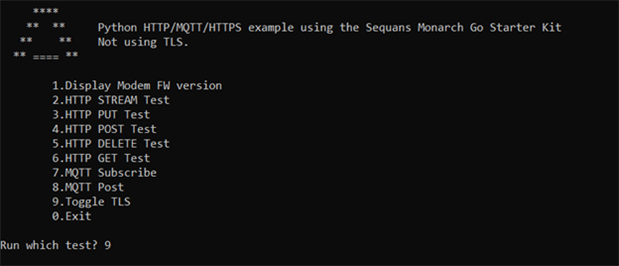

With internet connectivity confirmed, AT commands can be used in Python scripts for network communications.  The example (implemented in Python3) provided at  https://github.com/Avnet/sequans_python demonstrates both HTTP and MQTT communications.  When started, the example script displays the following to the user:

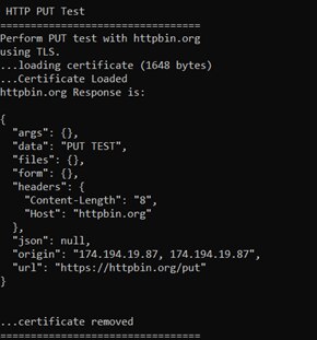

For HTTP communications, the script interacts with http://httpbin.org--a simple HTTP Request & Response service--by sending PUT, POST, GET, DELETE, and STREAM commands.  When httpbin.org receives the commands, it echos the command back.  An example using a PUT command is:
You can also use HTTPS rather than HTTP by toggling TLS prior to issuing the command.  In the example above, TLS was enabled so the response url is displayed as "https://httpbin.org/put".

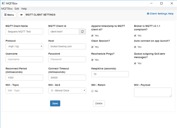

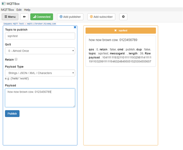

The example script also supports posting and subscribing to an MQTT exchange. To demonstrate interaction with an MQTT broker, the script uses HiveMQ and the Chrome browser application MQTTBox.  To begin, setup the MQTTBox application to use an MQTT Client id of 'client-test1' and a Host address of 'broker.hivemq.com'. This will allow you to monitor and post to topics from within MQTTBox.  The setup should look similar to:

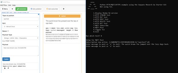

Once configured, you can monitor and post topics.  In the script, 'sqn/test' is the topic used so when posting to the Sequans module, use this topic (in the Topic to publish box) and whatever Payload you would like will be sent to this topic.  When the 'Publish' button is pressed, the payload will be displayed on the right side of the dialog showing the payload for the 'sqn/test' topic.  An example of this is shown below:
Using the example script provided, select either 7 or 8 to Subscribe/Post messages between HiveMQ, the MQTTBox application, and the Python script.  For example, in the following screen shot, an MQTT Subscribe action has been executed and the script then waits for a subscribed message to be received. When the payload is posted to the 'sqn/test' topic using MQTTBox, it will also be displayed in the Python Script as shown below.
   Similarly, when a Post is executed by the Python script (selection 8), the published message is displayed within MQTTBox as shown below:
