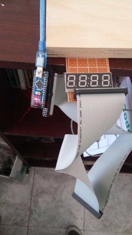

I have bought a 4 digit seven segment module on banggood.
1 Pcs 0.561 Pcs 7-Segment 4 Digit Super Red LED Display Common Anode Time - US$1.79
these things cost about 2$ and i wanted to test if they worth anything.
I have decided to connect them to arduino nano in a quick plug and play connection, so that it can be added for existing design using only 1 connector.
The thing about buying from china online is that you not always get what you order.
The module I received is CL5642BH and the module they published is HSX41056K.
So without any schematics i have decided to reverse engineering it using a breadboard.
Apparently the module turned out to be common anode as specified and with pin diagram as in arduino mega - How to wire up 4-digit 7-segment display? - Arduino Stack Exchange
When you google about these displays there is allot on confusion when to put the current limiting resistors, some say in the digits, some in the segments.
Actually I figured it out it can be both ways, only the code of the arduino is changed.
Then I found a nice library to deal with with that really simplifying it all
http://playground.arduino.cc/Main/SevenSegmentLibrary
You can config where you want to put the resistors and if its common anode/cathode or even more complex drivers and it works!
Just by reading the code you can see this lib is great.
Form factor:
As I mentioned i have decided to make the circuit as compact as possible.
Because of that I put the resistors on the digits (4 instead of 8 resistors) and I used perforated board.
The front side is quite neat, only display and 4 resistors (and connectors)
The rear side is quite messy
I was using an old IDE connector from an old computer to drive it all from the arduino
Open items:
  • The SevSeg library uses loop to always update the leds (kind of a tdma over the leds), I read around there is a was to use charlieplexing for keeping the leds on without the fluctuations.
    Still I didnt find any way to implement it on my display.
    Anyone have an idea?
  • Decreasing cable amount. Is there a module that uses i2c to only take 2 cables out of the arduino onstead of 12 cables?
Video of operation:

    idanre1 over 9 years ago in reply to jc2048 +1
    Hi Im actually use it to display text on a remote vehicle. The sevseg lib can do text also... Actually the brightness can be adjusted. I will paste my code at the buttom. You can also adjust the brightness…
  • jc2048
    jc2048 over 9 years ago in reply to idanre1
    Interesting application. I thought you might be doing a test instrument, or something like that.
    I had imagined it was a traditional scan, where you'd scan the anodes in turn and present the segment drive (in a 1:4 multiplex). If the brightness remains constant, you must be scanning the segments in turn and deciding whether or not to drive the anode (an 1:8 multiplex).
    I don't see that a Charlieplex helps. With the anodes connected, there's no possibility of having diodes back-to-back nor of maximising the connection possibilities between the IO pins, which is where the savings come from.
    I don't have much experience with Arduino programming. Can't you set up a timer to generate an interrupt at regular intervals and use the interrupt routine to drive the display? That way it would be a backgound process and you could do what you like with the rest of your code without it having an impact on the scanning.
    Hi
    You can also adjust the brightness using which resistors values you put in the circuit. Here i have 1k. When i tried 100ohm it was too bright.
    Thanks allot for the i2c extender that what exactly what i wanted.
    Also do you have a clue if i could use charlie plexing? This will decrese mips from the arduino and remove blinking from the display.
    This is my code for now.
    I just changed the pins which i used. And the brightness.

  • jc2048
    Good to see you experimenting and working things out for yourself. What are you going to show on the display?
    If you just use the four resistors, doesn't the brightness change depending on how many segments are on?
    You could try an I2C expander like this if you want an I2C connection:
    http://uk.farnell.com/microchip/mcp23017-e-sp/ic-io-expander-16bit-i2c-28dip/dp/1332088
    There's a whole range of them. I think you can get similar parts for SPI, too.
    Alternatively, you could use a microcontroller acting as an I2C slave. Advantage of that is the uC could do the scanning and the Arduino would only need to send data as and when it changed.
