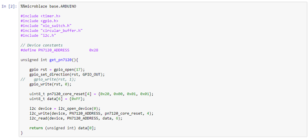

After finding an I2C example on the Raspberry Pi headers, I thought it should be reasonably simple adapting this to some different pins. Unfortunately this wasn't the case. This is the code I came up with, and despite trying lots of variations, whenever I executed the code, it hung. I couldn't see any way to find where it had hung without some clunky pin toggling either.

    After more digging I can send something out on the I2C pins without crashing anything. The magic seemed to be using i2c_device 0 and not bothering with set_pins. However what comes out is not valid I2C. It appears to be just one byte roughly resembling the I2C address for both write and for read.

    Do you have the I2C device actually connected to the pins? If not, it will stop when it doesn't get an ack back at the end of the address.

    Where did your 0x28 address come from? Was it an actual example intended for this IP block's implementation or did you find it from a software library for some other device?
    The device datasheet says either 0x50 or 0x52 for a write (depends on the select address pin). The 0x50 could be the same as 0x28 [sometimes software libraries treat the address as being an address part that you give them, shifted one left to make room for the r/w bit].
    Further thought. Are you sure this is a master interface? There's a [small] possibility it's a slave [so that you could plug in an Arduino board and have it talk to the FPGA as though the FPGA were its slave peripheral].

    The 0x28 came from some working code from another device (Azure Sphere). That was a great suggestion to use 0x50 but in this case 0x28 was correct. I know some I2C libraries expect the address specified with the trailing bit and some without. i.e. some would append a 0 or 1 to 0x28 to get 0x50 (read) and 0x51 (write). Others would expect the address parameter passed as 0x50.
    It turned out I needed a slightly longer reset pulse and to wait a bit before I sent data and I'm now getting valid I2C data written to the PN7120! Reading is not quite there yet but I think I just need to wait for the device to signal that it's ready before trying to read. Anyway, work calls! I'll have to park it for now but it's always good to put something down knowing you're making progress.
    I can still get the board to lock up though. Maybe there's a limit on how many Microblaze instances can run and I'm creating one each time?
