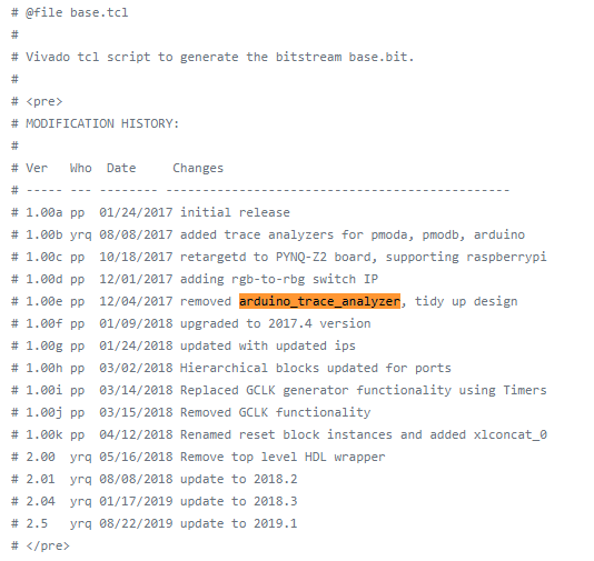

  • ralphjy
    ralphjy over 6 years ago in reply to ralphjy
    I just looked into the base.tcl file and the arduino_trace_analyzer was removed quite a while ago - no explanation why.  I was considering rebuilding the base overlay to add this back but I guess we're going to learn how build overlays in the next workshop.  Hopefully it was not removed because of some issue.

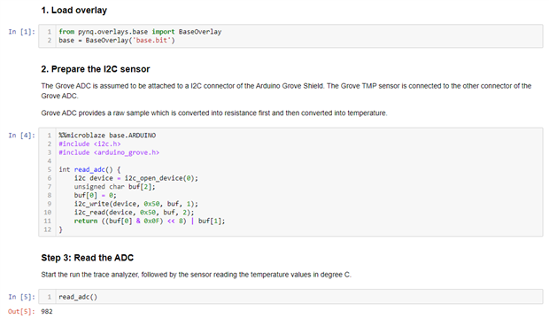

  • ralphjy
    ralphjy over 6 years ago in reply to Fred27
    It might be the specific device that you're talking to needs to be initialized in a specific way.  I just tried moving my Grove ADC from the PMOD port to the Arduino shield and tried the same configuration that you tried (using the default I2C pins on device 0).  It worked without any issues.  I tried hooking up the trace analyzer but for some reason the BaseOverlay does not include a configuration for the trace analyzer on Arduino, only on PMODs and RPi.  The address for the ADC is 0x50.
