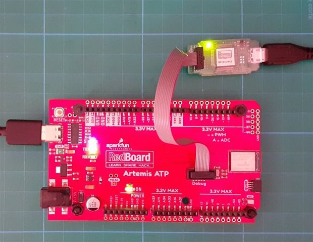

Serial and JTAG Programming
The RedBoard Artemis has two methods for programming. The most common is the USB C connector that operates as a USB to serial bridge. By simply pressing 'Upload' in the Arduino IDE or 'make bootload' from the SDK the firmware on Artemis is updated.The RedBoard Artemis uses the CH340C. The driver should automatically install on most operating systems.
The second method is JTAG programming. An unpopulated JTAG footprint is available for more advanced users who need breakpoint level debugging.
Serial Wire Debug
Serial Wire Debug (SWD) is really just a modification/implementation of JTAG specifically for ARM processors. SWD puts the 2 pins (SWDIO and SWCLK) on top of the JTAG pins allowing a user to use either JTAG or SWD without the need to breakout more pins.
Required Materials
  • RedBoard Artemis ATP
  • USB cable Type CUSB cable Type C
  • J-LINK EDUmminiJ-LINK EDUmmini

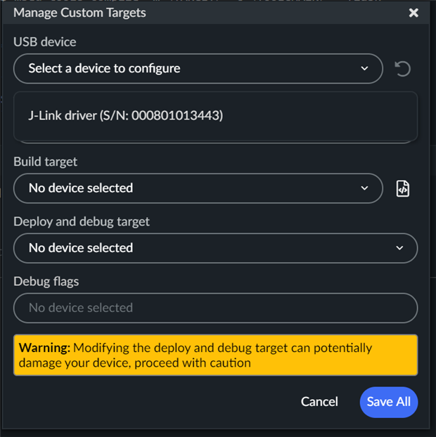

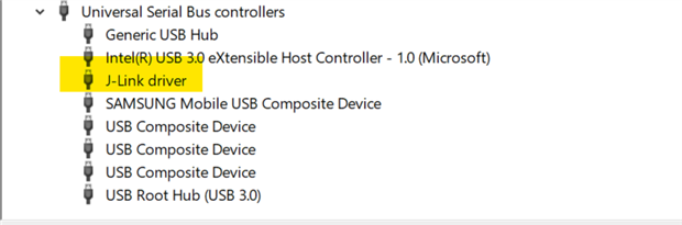

Connect your J-link
Go ahead and open the Jlink Configurator and see if your programmer needs an update.

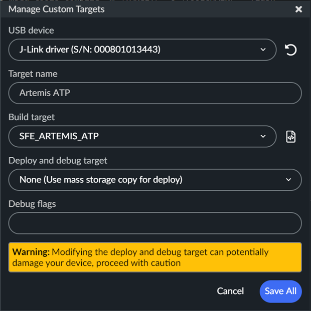

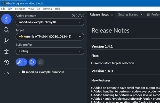

Blinky example. Project Setup

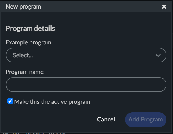

Open MbedTm Studio and create a new project.
From the menu, select File > New Program....
A New program dialog box should open.

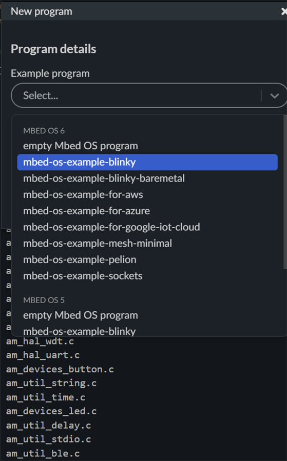

We'll begin with the Blinky example, from the Example program drop-down list, select in the MBED OS 6 list
For the MbedTm OS Location, select the "Link to an existing shared Mbed OS instance" option
Browse for the location noted earlier, to the ambiq-apollo3-dev branch of our fork of MbedTm OS

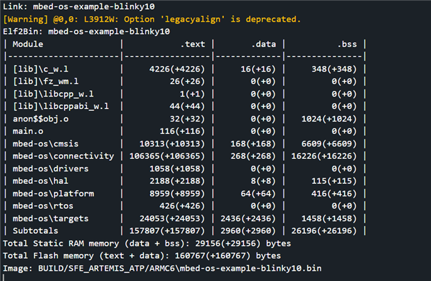

Clean and build the project
Build Project
Click the Build, hammer icon. This builds Blinky and stops.
Check the build output for the location of the .bin file.

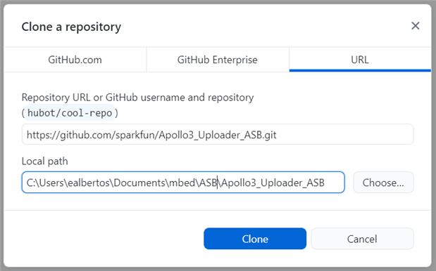

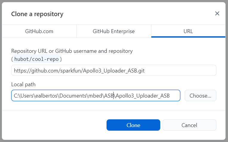

Clone the Ambiq Secure Bootloader (ASB) Upload
Development boards that utilize a WCH CH340C or CH340C Uart-to-serial chip will be programmed using the Ambiq Secure Bootloader (ASB).
https://github.com/sparkfun/Apollo3_Uploader_ASB
