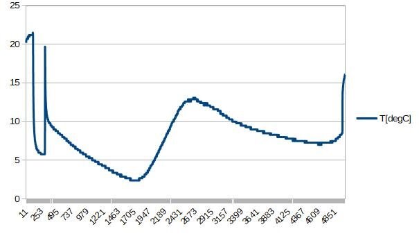

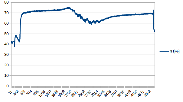

Anyway, I used the phone to download an App to the board which logs time, temperature, pressure and rH to the internal 8GB SD card, such that the sampling rate was set to 30 seconds. The board was then commanded by the phone to start logging.
The board then went in my fridge for an hour or so. It logged 5C!
Then in the loft for two days. We have had problems with condensation up there and I was a bit worried that my stash of surface-mount components might suffer.
That is the reason to do the experiment.
Results: 70% rH in the loft!
Also good: the LiPo battery seems to go on and on. I will do some battery life tests, but at the 30 secs per sample it should last for weeks!
Over 2 days, the logged CSV file was only 222KB.
Here are the graphs from LibreOffice...
temperature (above) fridge at 5C then loft.
Now rH...
