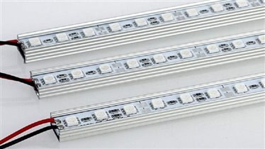

Configuration: The physical configuration of the LED arrays I'm using is strips of 36 total (27 Red and 9 Blue) LEDs. Each strip is 0.5m in length and approx. 1.3cm in width. They are sold in kits of 5 strips for $35 per kit. I am using two kits. See the picture below.

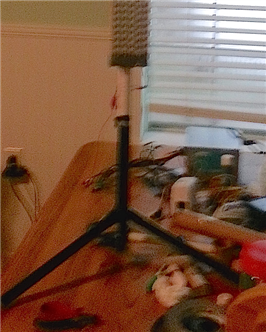

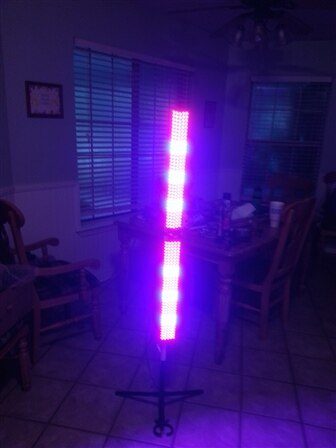

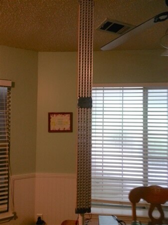

I have mounted the strips on a  9.5mm x 6.5cm x 1m plywood backing strip. Each kit is mounted five across. Then I've attached the plywood backing pieces to PVC pipe with the two kits being mounted one above the other using a PVC coupler. See the picture below. I am using an old modified guitar stand to support the entire structure. It turned out to be quite stable and adjustable. See pictures below.
Power output: Using a simple multimeter I have determined that my LED light array draws a total of approx. 5A @ 12VDC. So the input power is 60W. The manufacturer claims a power factor of 97%. Since the concept of power factor doesn't apply to DC circuits, as the have no reactance, then the term power factor doesn't really apply. So I'm assuming they are referring to power efficiency, or that input power which is actually seen in the output of the circuit. I don't know this for sure. So I believe the total output power of the array should be approx. 58W.
Currently, the light strips are connected such that each corresponding top and bottom strip is in series while the five sets of two are in parallel. I could probably get a little more power out by connecting all strips in parallel. But the series/parallel combination turned out to be very convenient and I believe I have enough power output for the application.
