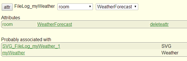

The FileLog should automatically be created if not the following command will create one.
define FileLog_myWeather FileLog ./log/myWeather-%Y-%m.log myWeather

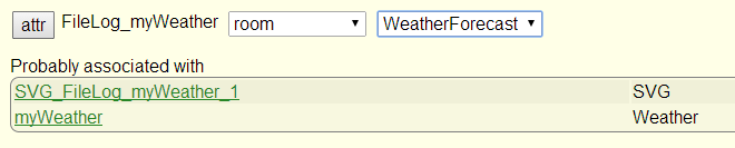

You will also want to set the attr logtype to text and room to WeatherForecast too for now using the attr button
Navigate to this page http://<fhemhost>:8083/fhem?detail=FileLog_myWeather
And add the corresponding attribute seen in Figure 1.4
Header 1
Figure 1.4 FileLog Room
Click the attr button
Header 1
Figure 1.4a FileLog Room Attribute

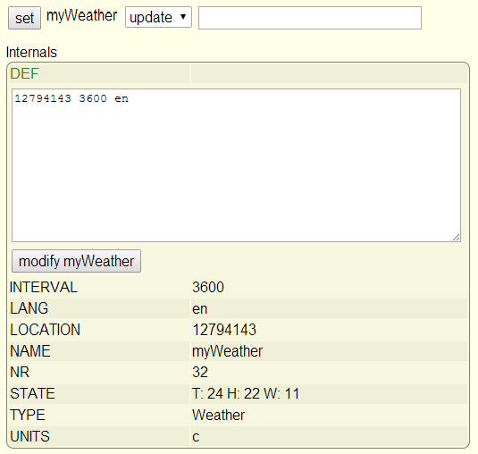

You'll notice my define myWeather (WOEID) is set to 12794143 if you wish to change your location simply modify the WOEID with a new Geo Location and save the config. Fhem will automatically auto populate the rest based on this.
This can also be done on the detail page:
Header 1
Figure 1.6 myWeather settings

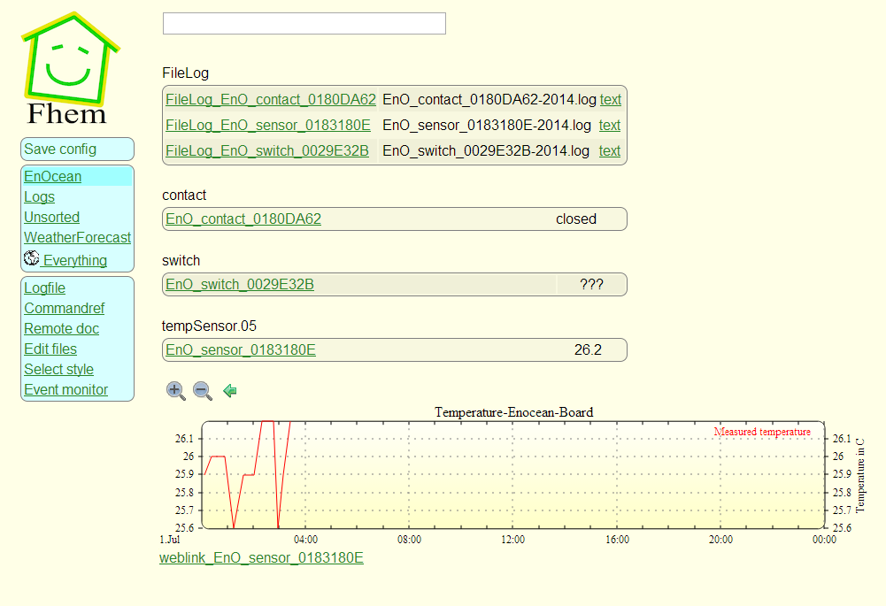

C) Adding an EnOcean STM33x Temperature Sensor graph
Now that you have the understanding of the commands I'll simplify this.
Edit the fhem.cfg file by navigating to
http://<fhemhost>:8083/fhem?cmd=style%20edit%20fhem.cfg
Scroll to the bottom and add the following weblink and click Save fhem.cfg
####    EnOcean STM33x Temp Sensor Weblink
define weblink_EnO_sensor_0183180E SVG FileLog_EnO_sensor_0183180E:temp4:CURRENT
attr weblink_EnO_sensor_0183180E label "Temperature-Enocean-Board"
attr weblink_EnO_sensor_0183180E room EnOcean
When you navigate to the EnOcean Room you get a nice temperature graph already to go.
Header 1
Figure 1.7 EnOcean Graph
