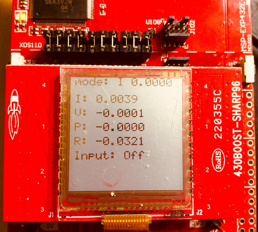

The TI-RTOS distribution i was using for the black pre-production MSP432 LaunchPad didn't have an LCD driver. Someone backported it for that release:
this port was the work of: John Pocreva
https://e2e.ti.com/support/embedded/tirtos/f/355/t/552357
That backport was a great piece of work. I'm saying goodbye to it now though, because SimpleLink has the driver.
There's very little that changed. I have to initialise it differently and that's about it.
#include <ti/display/DisplayExt.h>
    Display_init();
    /* Initialize display and try to open LCD type of display. */
    Display_Params params;
    Display_Params_init(&params);
    params.lineClearMode = DISPLAY_CLEAR_BOTH;
//    Display_Handle hLcd = Display_open(Display_Type_LCD | Display_Type_GRLIB, ¶ms);
    Display_Handle hLcd = Display_open(Display_Type_LCD, &params);
    if (!hLcd) {
        return NULL; // we didn't get a display handle. Check if the following is defined: BOARD_DISPLAY_USE_LCD
    Graphics_Context *context = DisplayExt_getGraphicsContext(hLcd);
    GrContextForegroundSet(context, ClrBlack);
    GrContextBackgroundSet(context, ClrWhite);
    GrClearDisplay(context);
    GrContextFontSet(context, &g_sFontCmss12);
    GrStringDraw(context, "The Breadboard", -1, 10, 15, 0);
    GrStringDraw(context, "Electronic Load", -1, 15, 30, 0);
    GrStringDraw(context, "Copyright Free", -1, 13, 45, 0);
    GrStringDraw(context, "Version 0", -1, 22, 60, 0);
    GrFlush(context);
(if you see strange text in this code, it means &params. The syntax highlighter on the forum is playing up lately)
That's actually it. By default the display works compatible with UART output. But you can use the graphic libs to draw, position, etc ...
