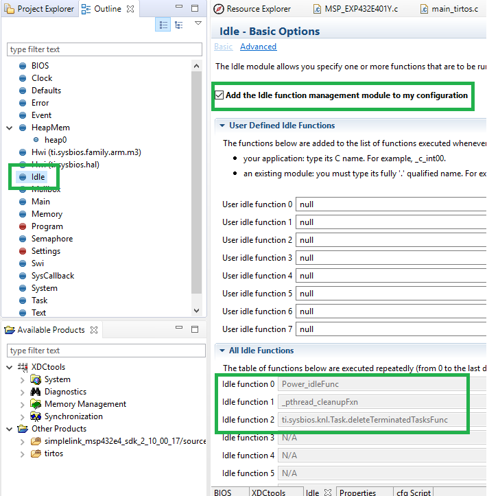

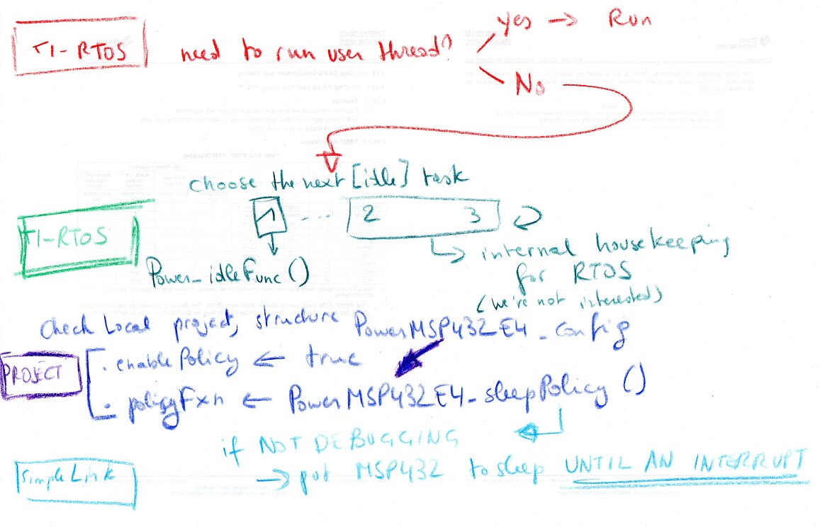

The RTOS is configured to run a few tasks when it's not running any of your threads:
  • do self-maintenance
  • save power consumption by invoking the Power_idleFunc().
The self-maintenance is something TI-RTOS does to keep internal health (mop up resources of closed tasks and POSIX pthreads). We're not going to review them here.
The functionality that's performed by the idle function Power_idleFunc()is what we're interested in. Thats the one that puts our MSP432 microcontroller in sleep whenever possible;
Power_idleFunc()is part of the SimpleLink library. The documentation of that function is available online.
It will look for a structure that defines the power policy. We'll go deeper into this in the next section, because the structure is defined in your project.
What I want to draw your attention on now are two values that are used by the TI-RTOS power management and a default power policy function, PowerMSP432E4_sleepPolicy().

policyFxn is a pointer to the function that TI-RTOS calls when it decides to run Power_idleFunc(), if enablePolicy is true image.
This may sound complex, but you'll see how policyFxn and enablePolicy are defined in the next section. And as stated before, if you don't do anything, it'll work.
PowerMSP432E4_sleepPolicy()is a default implementation of a power profile. It's defined in the SimpleLink libraries and your project will use this as the policy if you don't make changes to its setup.

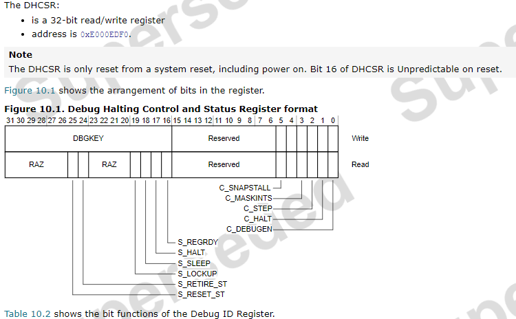

#define DHCSR (*(volatile uint32_t *)0xE000EDF0)
#define C_DEBUGGEN 0x1
 *  ======== PowerMSP432E4_sleepPolicy ========
void PowerMSP432E4_sleepPolicy()
    /* invoke WFI only if CPU is not in debug mode */
    if (!(DHCSR & C_DEBUGGEN)) {
        __asm(" wfi");
The function will check if you are in active debug. If yes, it won't sleep (it's common, sleeping messes up your debug session).
If you aren't in active debug mode, it will call the ARM WFI instruction. The controller waits for an interrupt and takes a nap in the meantime.

If you don't configure anything, you are good. Your project's board file (MSP_EXP432E401Y.c) will contain the necessary constructs to tell TI-RTOS to use SimpleLinks default (and good) PowerMSP432E4_sleepPolicy() functionality.
The static declaration below will be found by TI-RTOS and the settings taken over by its scheduler.
 *  =============================== Power ===============================
#include
const PowerMSP432E4_Config PowerMSP432E4_config = {
    .policyFxn = &PowerMSP432E4_sleepPolicy,
    .enablePolicy = true
If you keep this intact, your project will go to lower power mode whenever possible. If you have a better or worse sleep requirement, you can provide your own function to handle the situation.
If you don't want any low power functionality, set enablePolicy false.
