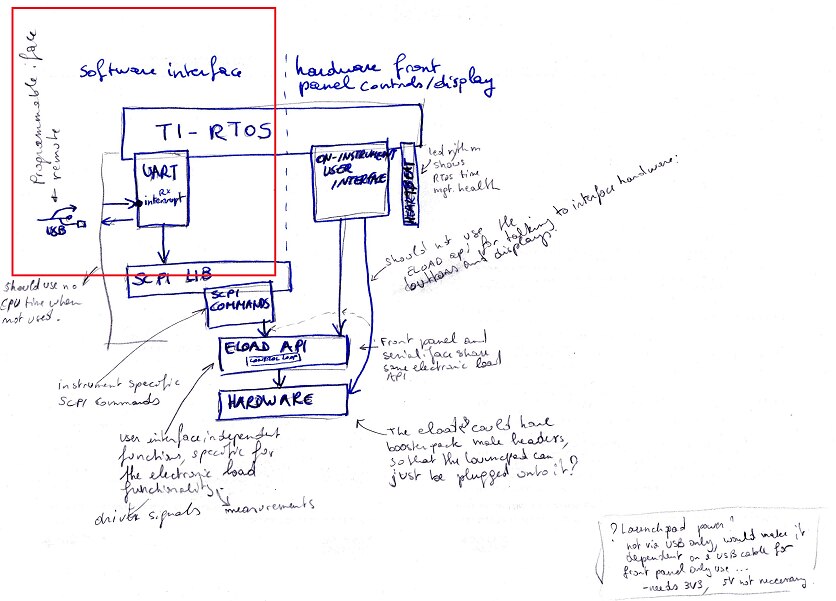

Exercice 1: Threads
A TI-RTOS task turns into a POSIX thread. In the original firmware for the electronic load, I used the RTOS GUI to configure them.
In the POSIX paradigm, you declare and create them in code.
The heartbeat thread described here is a low priority job that will blink a LED on the LaunchPad. It helps to visually check the health of the RTOS while developing.
Any activity that impacts the bandwidth to run jobs regularly is easy spotted because the LED's rhythm gets disrupted. That's something that can be spotted by just looking at the board.
At the startup of the firmware, before the RTOS is started, The tasks are created.

Exercice 2: UART , Triggers and Semaphores
I'm starting with the UART interface because it uses some interesting RTOS structures: interrupt driven IO and semaphores.
The task to read the UART is interrupt driven. Our task always sleeps and only wakes up when a character arrives at the USB Rx line.
We use a binary semaphore for that - one that always blocks unless a process (in our case, serial in interrupt) posts to that semaphore.
sem_t SEM_uart_rx; // this binary semaphore handles uart receiving interrupts
The semaphore gets initialised at the start of the UART task:
    iError = sem_init(&SEM_uart_rx, 0, 0);
Then, in that task's while loop, the process blocks on that binary semaphore and goes to sleep. Check the sem_wait() call.
