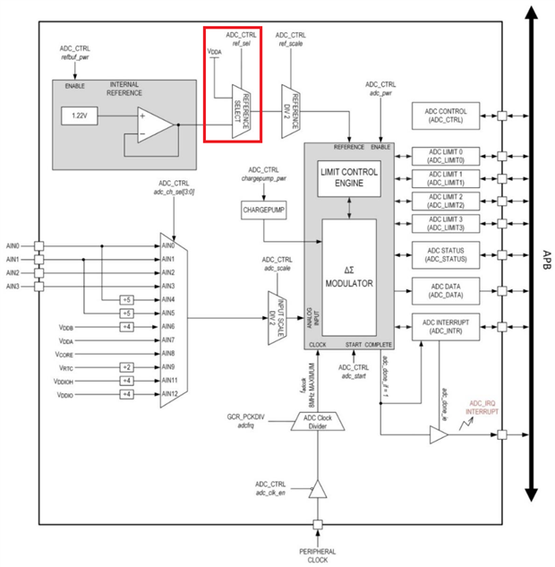

Before start testing the functionality of ADC lets look at the important details about ADC mentioned in USER guide. The block diagram of MAX32650 ADC shows all the important functionality. In the block diagram as shown in figure-2 the highlighted part doesn't exist/work. So its important to know before using the ADC and all of our calculation should be based on 1.22V internal reference.
figure-2: Block Diagram of MAX32650 micro-controller ADC - where ADC_CTRL > ref_sel doesn't exist/work
As the title suggest that it can be used to measure voltages well above the absolute maximum rating. So how is this possible when the equation 10-5 of MAX32650 (figure-3) while following the input/ref scale limitations of Table10-2 (figure-5) and also the ADC block diagram shows that AIN4=AIN0/5 and AIN5=AIN1/5? The answer is simple the data mentioned here is little confusing because user can assign the different input_scale and ref_scale to these with only limitation of maximum voltage limit will not be same as theoretical limit obtained from equation given below. During actual testing it is found that actual scaling for AIN4 and AIN5 is 5 and SDK ADC library is assigning constant 1 to input_scale irrespective user assigned value to it. In other word only the ref_scale for the AIN4 and AIN5 is user select able and input_scale value is ignored.
If using the default ADC library with ref_scale '0' the ADC_DATA equation given in figure 4 provides the correct ADC reading. According to this equation the maximum possible ADC reading should be 12.2V at 0x3FF but in reality the maximum achievable value is ~9.7V OR ~0X32F. If the Input voltage is increased further than ~9.7V the ADC voltage is dropped to ~6.28V OR 0x20F. So it means this the actual hardware limit instead of 5.5V when ref_scale is set to 0. The maximum limit ~5.5V is if and only if when ref_scale is set to 1. Apart from these significant errors in User guide there are several other typing mistakes in ADC section alone.
So we can find in ADC library that ADC input_scale for all the channel except first 4 is always 1. For channel 7 and channel 8, it is mentioned in the manual but not for rest of channels.
The ADC library code in ADC_StartConvert function that is setting the input_scale to '1' irrespective of user selected value.

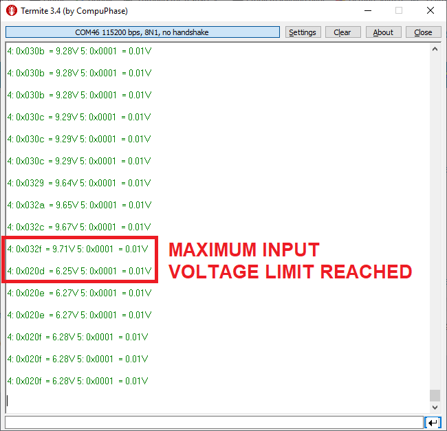

The code to read the up to 9.5V (maximum ~9.7V) signal at AIN0 and AIN1 is given below. By following the scal limitation table the ref_scale value should be 1 for both of these channels. but for the experimentation only it is set to 0.
/* Convert channel 4 : input scale value is used */
#ifdef USE_INTERRUPTS
     adc_done = 0;
     ADC_StartConvert(ADC_CH_0_DIV_5, 0, 0);
     while (!adc_done);
#else
#endif
     overflow[0] = (ADC_GetData(&adc_val[0]) == E_OVERFLOW ? 1 : 0);
/* Convert channel 5 : input scale value is used*/
     adc_done = 0;
     ADC_StartConvert(ADC_CH_1_DIV_5, 0, 0);
     while (!adc_done);
#else
#endif
     overflow[1] = (ADC_GetData(&adc_val[1]) == E_OVERFLOW ? 1 : 0);
The code to display the AIN0 and AIN1 is
uint8_t fmtstr[40];
uint16_t adc_val[2];
unsigned int overflow[2];
snprintf((char *)fmtstr, 40, "4: 0x%04x%s = %.2fV 5: 0x%04x%s = %.2fV",
         adc_val[0], overflow[1] ? "*" : " ", ((double)adc_val[0]/1023.0)*10.0*1.22,          // (ADC_DATA/(2^N-1)) x (Vref/2^ref_scale) x VIN_scale
         adc_val[1], overflow[1] ? "*" : " ", ((double)adc_val[1]/1023.0)*10.0*1.22);
printf("%s\n\n",fmtstr);
When ref_scale of '1' is used for the above channels then to obtain the right voltage, replace the 1.22 reference voltage multiplier with 0.61 in the above code.

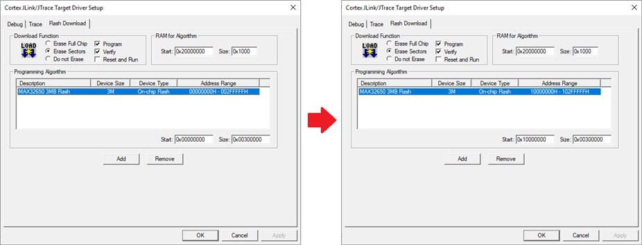

In Keil the MAX32650 Ev-Kit ADC example need small setting change as shown below:
figure-6: Flash download setting for ADC example - MAX32650 micro-controller

figure-X: Maximum ANI4 and ANI5 Analog inputs limit with unmodified ADC library (input_scale is 1) and ref_scale is 0 - MAX32650 micro-controller
figure-X: All Analog inputs channels connected with Power supplies with unmodified ADC library (input_scale is 1) and ref_scale is 0 - MAX32650 micro-controller
For this experiment use the voltage supply with very limited current capabilities is used because when voltage is increased from ~9.7V, the voltage is dropped inside of ADC/micro-controller and excess current start flowing even though the voltage level at external AIN0/AIN1 pins remain at actual level. If the supply will be able to deliver lots of current then it can damage the micro-controller. SO APPLY ANY VOLTAGE ABOVE 9.5V AT YOUR OWN RISK.
