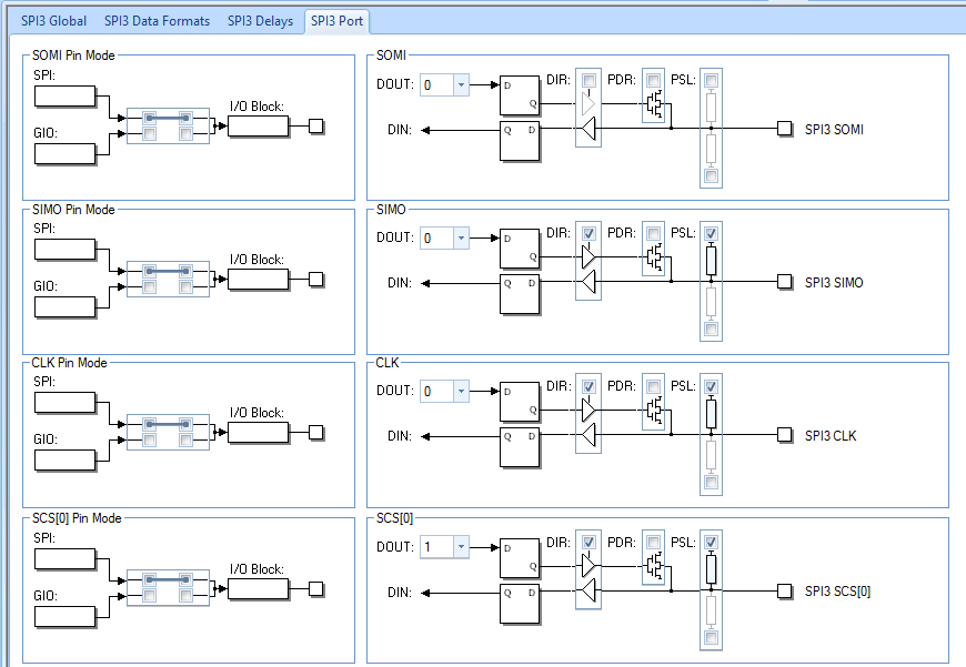

Enable the SPI driver. You can see in part 2: Circuit and Test Bed why I'm selecting SPI3.
On the multiplexing page, I've activated the SPI3 pins.
I first selected the global MIBSPI3 checkbox, That activates all SPI3 related pins. Because I only need 4 of them, I've deactivated the ones I don't need.
(I've kept SOMI, SIMO, CLK and CS_0. Others, like CS_1, CS_2, ..., ENA I've deselected again because I'm not using them.
This is not strictly neccessary, but my personal style is to only make pins functional that I'm using, and leave others in their default assignment.)
I've configured the SPI peripheral, loosely image based on the memory's datasheet:
(note that my baudrate is awfully off. I have to downscale the SPI clock too get within a reasonable range for the , but haven't done that yet:
image image
I've only defined the pins that I am using:
Then I generated the source in HALCoGen.
