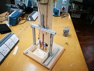

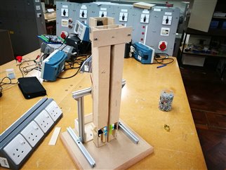

The main design consists of two towers to hold the blocks. Each tower can hold about 10 blocks.

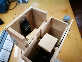

For Sorting the blocks into the towers we have a small platform which rotates 45 degrees either direction to dispense a block into a tower. The color sensor will be mounted on one side of the inside of the towers to. The sorting works when the PC sends a 'G' command, The Mbed reads the color sensor and sorts it into a tower which is not full, and sends the servo command to the FPGA to move the servo.

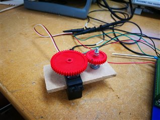

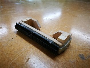

To dispense the Blocks from the bottom of the towers we use a kicker mechanism which is driven by a servo with a 2:1 gear ratio, this will give us about 75mm of movement on the kicker which will be enough to move the blocks into either the Recycle bin or the Dispense bin.

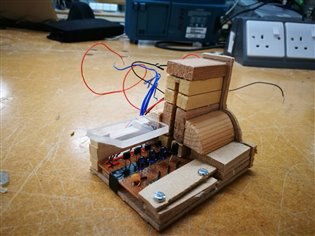

The card reader uses four Sharp IS471S to read the Value of the Card reader and return it to the Visual C# and store the value within the MBed.

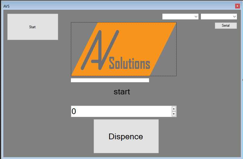

We have also managed to complete the Maintenance mode software and have published it to allow us to all have a copy on our laptops. There are still some small issues with the software, but the majority work and I am relaying on the rest of the team to report back any issues the find with the software.
The only other modifications that need made to the Main software for running on the device is minor modifications to the layout to allow it to go full screen on the tablet without looking stretched out.
There is one more issue that arises during the development of the software. The second language we are using is Spanish, and we tell the customer what color they are allergic to, So think what the Spanish word for black is and say it with an american accent (the current speech language on my pcs). I have tried installing Spanish language packs, yet no luck; if i cannot fix it we may end up changing the language to avoid any misunderstanding.
