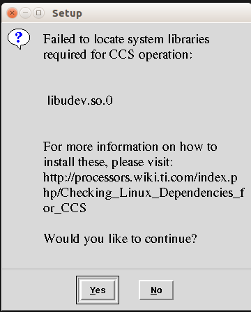

Fig 1 : This warning is a known problem. You cam proceed with an 'Yes' as it won't create problems.

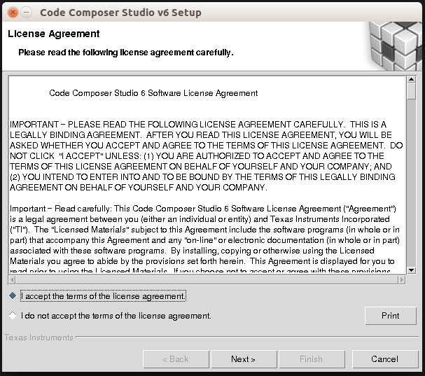

Fig 2 : Here you have to click the accept option.

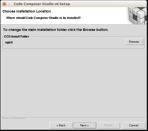

Fig 3 : Here you have to set the path to which CCS should be installed. Leave the path as default.

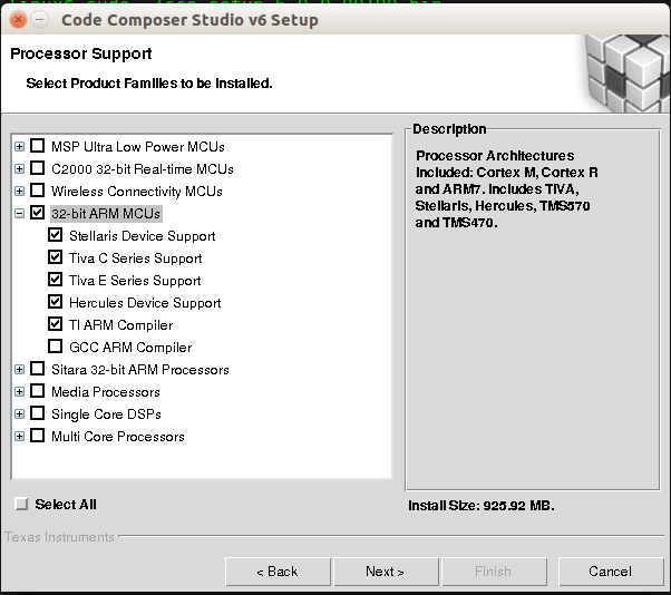

Fig 4 : Here you have to select the components to install. Make sure that the components I selected in the
screenshot is selectedin your window also.If you want additionalcomponents, you can select tham too.

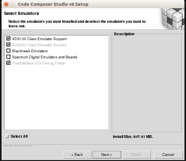

Fig 5 : Selecting Emulators. Default will be fine.

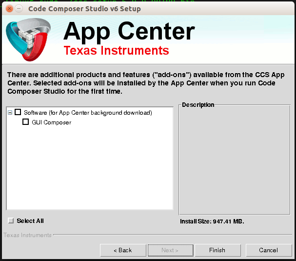

Fig 6 : If you wish to install the additional components to be downloaded from web, you can select them.
For now we will leave it unselected.

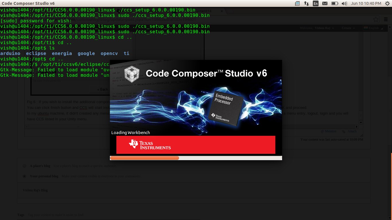

Fig 7 : CCS starting up.

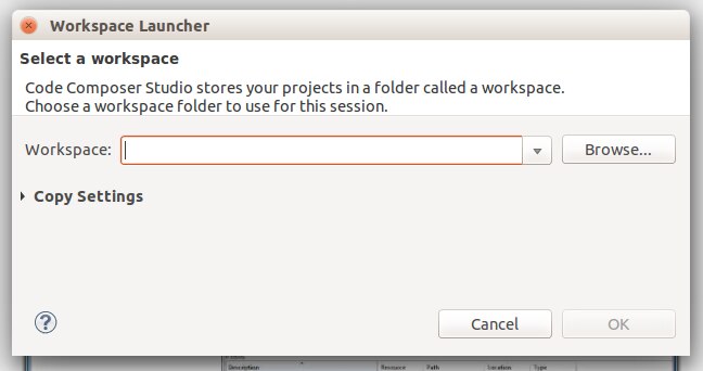

Fig 8: Set your workspace. For those who don't know the concept of workspace, default will be fine.

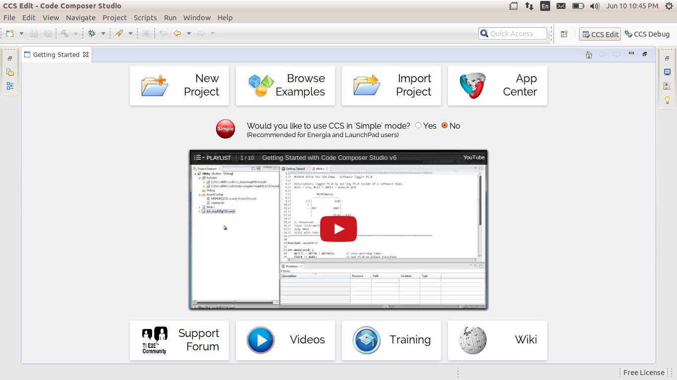

Fig 9 : CCS welcome screen.
