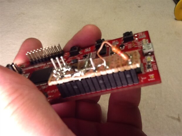

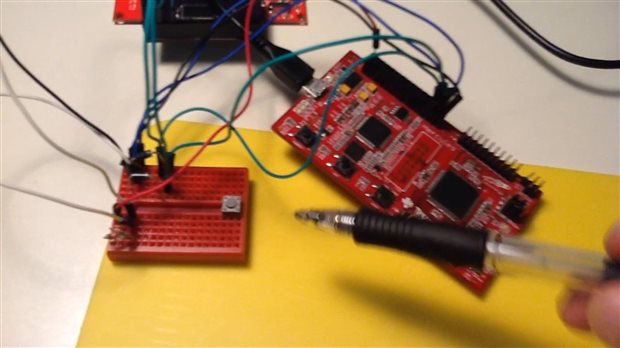

I've been working on a breadboarded BoosterPack to test the CAN modules on the TI Hercules LaunchPad, without transceivers or real CAN bus.
This is inspired by the following Siemens application note AP2921 On-Board Communication via CAN without Transceiver.
The example allows you to run and probe the canIntCommunication example from HALCoGen by using 1 resistor, 2 diodes, some wire and a breadboard.
For learning use only. This design is not intended for use outside your lab. See this design for a fully functional CAN bus.

  • Learn CAN with your LaunchPad and a few passive components
  • the CAN1 and CAN2 module on your LaunchPad can talk to each other - just like with the bigger development boards
  • You can probe the signals with oscilloscope and logic analyzer
  • Low entry point to experiment with CAN

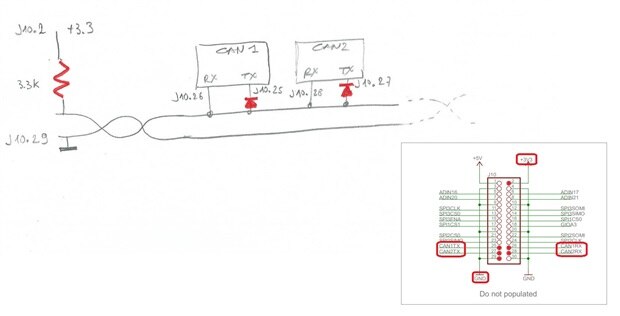

The poor man's can bus
A proper CAN implementation uses tranceivers and twisted pair wiring. And in an automotive setting I would not use anything different.
But for experimenting purposes, there's a simpler solution. You can replace a driver by a single diode on the transmit line:
The launchpad has 2 CAN modules, but no driver. In a test setting, that driver is not really needed.
Send and Receive of all CAN devices use the same single wire. The only thing we have to take care of is that the send lines don't conflict.
A simple isolation diode does the job. It takes care that a transmit line can drive the line without having to fight with the line's level.
If there's a conflict between senders, the diode takes care that it doesn't result in overload of the CAN peripheral.

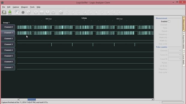

Result
Here's a sample taken with my protocol analyzer (a Papilio Pro loaded with the LogicSniffer design, with OpenLogic Sniffer as client):
Nothing spectacular here. But it's now possible to start digging into the CAN protocol with the Hercules LaunchPad without additional investment. A few scrap parts will do.
