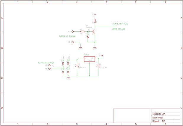

In this small project, design a frequency meter high accuracy parser should I use a timer with a definition of microseconds, the Hercules RM57 has internal modules for measurement of time with high precision, in my application I use a common transformer that reduces the voltage, our goal is to measure the frequency is accurate.
The frequency is the same throughout the country (Peru), so in factories that use high power motors must have the same error rate that we introduce at home.
The line frequency variations are bad, because they reduce the lifetime of high-power engines, these variations produce that warm the engine and vibrate reducing their lifetime, one solution would help monitor the frequency of feeding the engines not work with speed and provide preventative maintenance.
Schematic and BoosterPack
