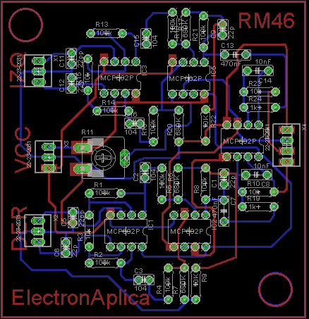

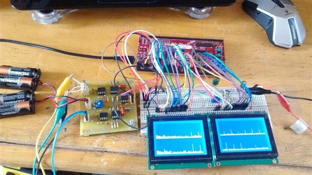

Improvements myoelectric sensor circuit is performed.
improvements:
- No Bandstop filter 60Hz / 50Hz is used
- The bandpass filter is 300Hz to 3KHz
- Filtering is entirely digitally Fourier
- The MCU digital filtering helps in reducing the circuit
              General circuit implemented
Amplifiers - MCP6022 / Microchip, do not use a single integrated circuit as an amplifier for reasons of flexibility in design.
Final Schematic Circuit
Boardimage
Video of the last application made
Link Schematic:
http://www.mediafire.com/download/ug2qtre3j4q88ma/Mioelectricidad.rar

    Nice update. It looks like you might be adding too much filtering, or there another reason for the delay in change after you begin to move the arm? DAB
  • martinvalencia
    martinvalencia over 11 years ago in reply to DAB +1
    yes, I add a delay in program for the reason that you can see the change of the numbers on the LCD while I record the video for youtube. the time spent for get the signals with ADC, calculation Fourier…
  • martinvalencia
    the time spent for get the signals with ADC, calculation Fourier and digital filtering signals for the arm right and left is in milliseconds, is very fast,
    couldn't see in the video!
    Regards
    Martin
