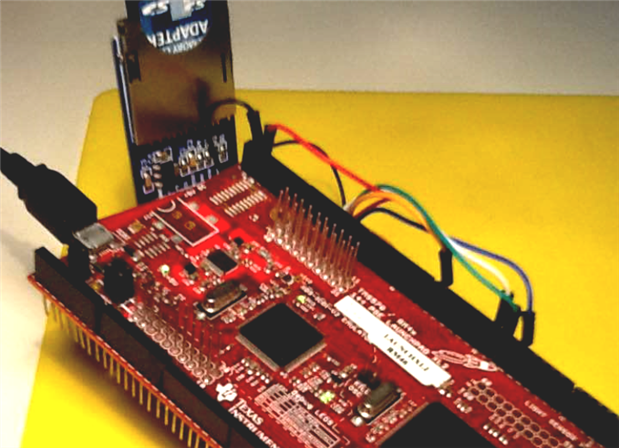

I'm about to close a long outstanding task: Make SD Cards work on a Hercules LaunchPadHercules LaunchPad.
I've done several half-baked attempts since November 2013. Thanks to persistence (not mine, martinvalencia's), it's finally working now.
This blog explains how to set up your Hercules peripherals, and it contains some insights and optimizations that we can do to TI's port of fatfs.
We'll check what libraries we need, how to configure the SPI module and the real time clock, and how to enable the fatfs string write functions.
Our end goal is to have a working SD Card program that can write data, read files and list directories.
I'm using the Hercules RM46 LaunchPadHercules RM46 LaunchPad.

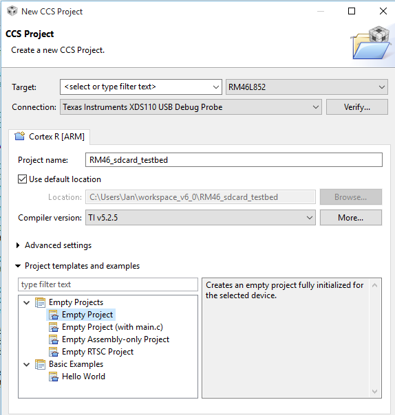

Create a Project

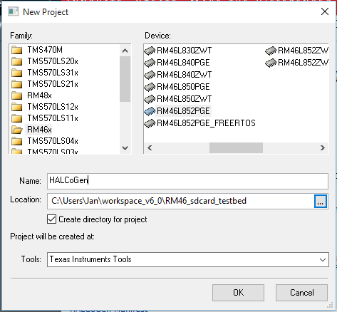

We start in Code Composer Studio. Create a new CCS project for your microcontroller
We'll generate a HALCoGen project too. We'll put it in a HALCoGen subfolder of our project.

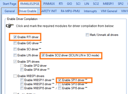

Drivers
Our first task is to enable the drivers we'll be using.
We'll be talking to the SD Card via SPI. I'm going to use SPI1. But you can use any of the other SPIs that are available.
The RTI will deliver the 10 ms clock tick to our SD library. We use the SCI2 driver to talk serial over USB (check your LaunchPad's scghema to see what serial peripheral is linked to USB).

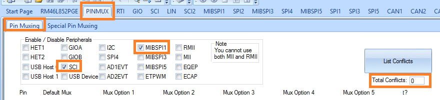

PINMUX
We're going to take care that our SCI and SPI PINS are set to the correct functions.
Take care that for SPI, you have selected MIBSPI1NCS_0, MIBSPI1CLK, MIBSPI1SOMI and MIBSPI1SIMO.

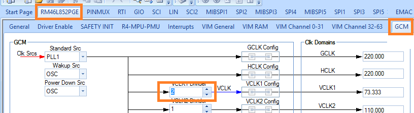

Clock Management
On the GCM tab, slow down the peripheral clock speed by setting the VCLK1 divider to 2.
This will allow us to get a reasonable SPI clock. If you have a proper PCB for your SD Card, you may reconsider putting this back to 1 and test if your design supports baud rates > 300kHz.

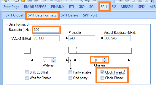

SPI
On the SPI1 tab, we make the settings to get a correct communication between Hercules and SD Card.
On SPI1 Global, leave all as it is.
On SPI1 Data Formats, adapt to this:

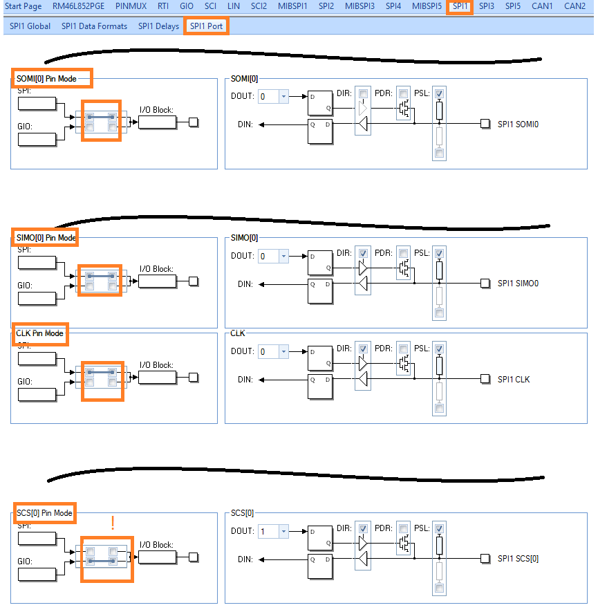

On SPI1 Port, carefully verify that the following pins are set to SPI - except CS[0]. That one is bitbanged by the lib and should be set to GIO.

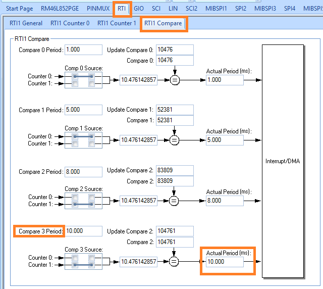

The Real Time Clock
Our SD implementation needs a ping every 10 ms. The RTI will serve that ticker.Comparator 3 is 10 ms by default, so let's use that.

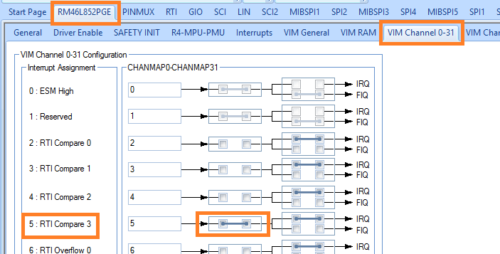

Interrupt handler for the ticker
We'll also enable the interrupt handler.

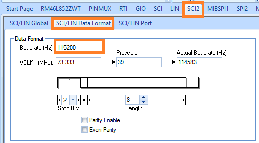

And finally, we'll configure the serial interface. That's the one we'll use to send commands to the Hercules, and read replies and messages. We'll use a terminal (puTTY, the CCS Terminal or whatever tool you prefer) to interact.

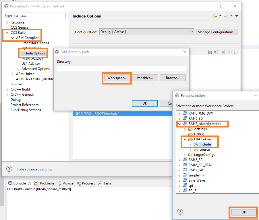

In CCS, right-click on the project, and select Properties from the context menu.
Confirm all.
Right Click on the project again, and select Build Project.

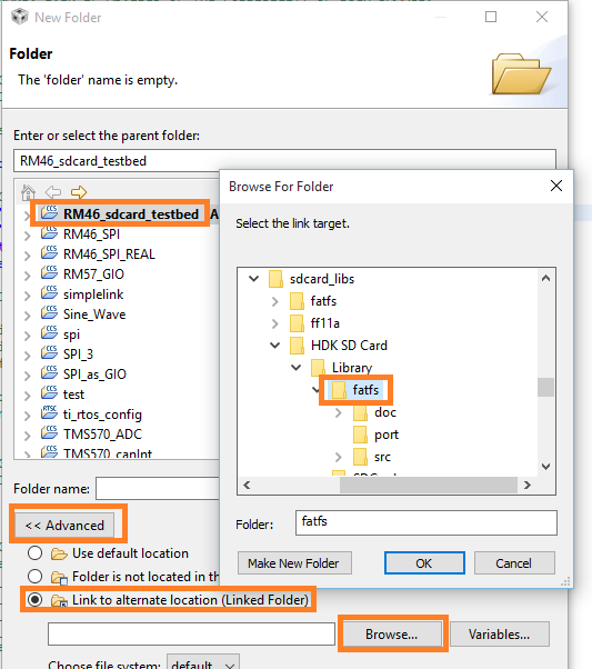

fatFS
Right click on the project, and add a New Folder.
Select Advanced, Link to Alternate Location
Browse to the place where you've dropped the fatfs sources
Confirm all.

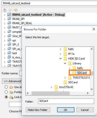

SD Card
Do the same with the SDCard folder

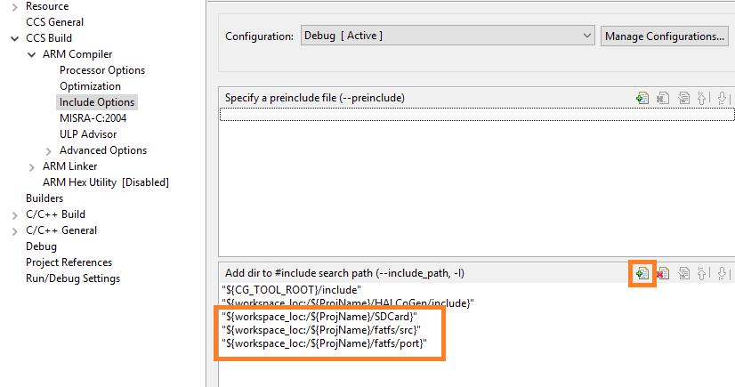

Add the headers to the include path
Just like we did with the HALCoGen include folder, add the source folders of the SDCard and fatfs/src and fatfs/port to the include path.
"${workspace_loc:/${ProjName}/SDCard}"
"${workspace_loc:/${ProjName}/fatfs/src}"
"${workspace_loc:/${ProjName}/fatfs/port}"

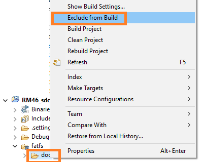

Exclude unused sources from buld
Some files and folders should not be compiled. We exclude them by right-clicking and selecting Exclude from Build from the contect menu
Entries to exclude:
  • fatfs/doc
  • fatfs/src/option
  • fatfs/src/diskio.c
  • fatfs/port/mmc-hdk-hercules1.c (in part2, you'll see that we roll our own - SPI port independent - version of this file)
  • fatfs/port/mmc-hdk-hercules2.c
  • fatfs/port/sample-mmc.c
  • SDCard/Load_bmp.c

    errata:
    If you have done the steps in this blog before October 7: I've made a correction in the serttings of the SPI1 | SPI1 Port tab.
    The SCI[0] pin has to be set to GIO. My original post wrongly marked it as SPI.
