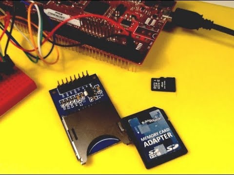

    .... and this is how I wired the LaunchPad's pins to the SD Card module:
    The black labels match with the silkscreen on the PCB (an LC Studio breakout. It was part of a set of components that I bought from someone who gave up the electronics hobby)
    Jan Cumps over 8 years ago in reply to Jan Cumps
    Here's the setup:
    (also showing two other Herculeses for a CAN bus experiment)
