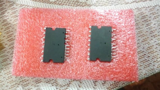

IGCM15F60GA:
Infineon-IGCM15F60GA

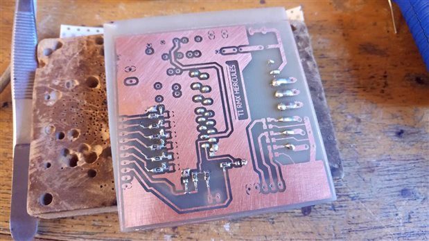

4. Schematic and Board

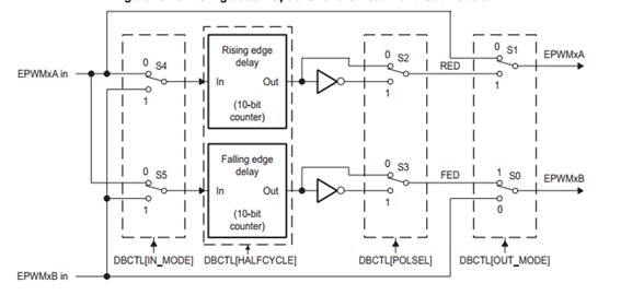

void TreePhaseInit() {
etpwmDeadBandConfig_t Set_DBand; // declaracion de variable
/*Configuracion de la banda muerta*/
Set_DBand.halfCycleEnable = false;
Set_DBand.inputmode = PWMA_RED_PWMB_FED;
Set_DBand.outputmode = PWMB_FED_PWMA_RED;
Set_DBand.polarity = Invert_PWMB;
/*Pagina 819 manual*/
etpwmChoppingConfig_t Set_config;
Set_config.duty = ChoppingDutyCycle_Four_Eighths;
Set_config.freq = ChoppingClkFreq_VCLK4_by_64;
Set_config.oswdth = ChoppingPulseWidth_8_VCLK4;
etpwmInit();
/*Configuracion del angulo de desfase entre los PWM generados*/
etpwmSetSyncOut(etpwmREG1, SyncOut_CtrEqZero);
etpwmSetSyncOut(etpwmREG2, SyncOut_EPWMxSYNCI); //SyncOut_CtrEqZero);
etpwmDisableCounterLoadOnSync(etpwmREG1);
uint16 phase1 = 59980; // 60°
uint16 phase2 = 54425; //120°
etpwmEnableCounterLoadOnSync(etpwmREG2, phase1, COUNT_DOWN); // seting del angulo de
etpwmEnableCounterLoadOnSync(etpwmREG3, phase2, COUNT_DOWN); // seting del angulo de
/* Set the time period as 1000 ns (Divider value = (1000ns * 2MHz) - 1 = 89)*/
etpwmSetTimebasePeriod(etpwmREG1, 33332U);
etpwmSetTimebasePeriod(etpwmREG2, 33332U);
etpwmSetTimebasePeriod(etpwmREG3, 33332U);
/* Configure Compare to register 1 */
etpwmSetCmpA(etpwmREG1, 33332 / 2);
etpwmSetCmpB(etpwmREG1, 33332 / 2);
/* Configure Compare to register 2 */
etpwmSetCmpA(etpwmREG2, 33332 / 2);
etpwmSetCmpB(etpwmREG2, 33332 / 2);
/* Configure Compare to register 3 */
etpwmSetCmpA(etpwmREG3, 33332 / 2);
etpwmSetCmpB(etpwmREG3, 33332 / 2);
/*Iniciando el control del modulo chopping de pwm*/
/*Iniciando la carga de los valor de la banda muerta 1000---> 510 microsegundos*/
etpwmSetDeadBandDelay(etpwmREG1, 1000, 1000);
etpwmEnableDeadBand(etpwmREG1, Set_DBand);
etpwmSetDeadBandDelay(etpwmREG2, 1000, 1000);
etpwmEnableDeadBand(etpwmREG2, Set_DBand);
etpwmSetDeadBandDelay(etpwmREG3, 1000, 1000);
etpwmEnableDeadBand(etpwmREG3, Set_DBand);

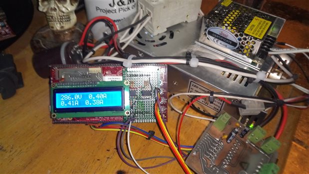

6. Video of the Implementation

    The output of the three phase generator is not sinusoidal, it is a square waveform, full of harmonics for my taste, I still have to work on the output filter to obtain a pure sine wave signal. Thanks for…
