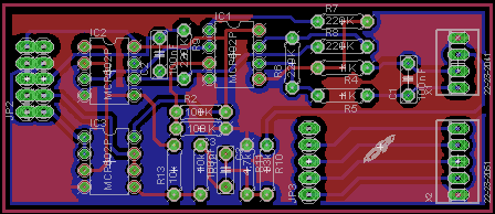

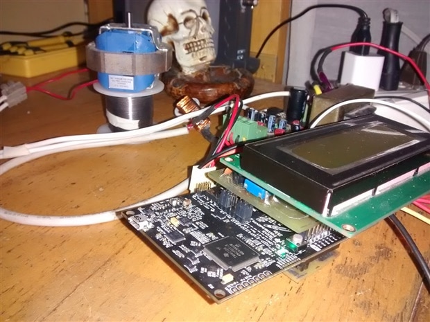

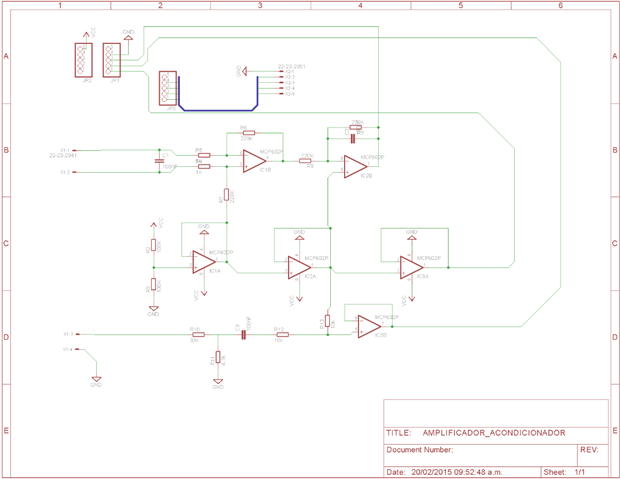

The project was developed by the need to know if a motor is operating.
why?
- Where have many motoros moving conveyor belt materials and the system detects that one of the 20 or 30 motor this unfortunate and you do not know which is presented.
solution!

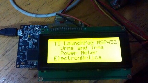

microcontroller-based low-cost, low power consumption and high reliability, the MSP432 device has these characteristics me to develop my application.

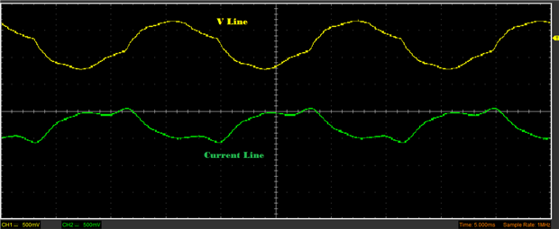

The circuit measures the RMS current and RMS voltage of the line, also indicated on the LCD screen if the engine is running.
there are cases that electrical tension exists between terminals of an engine but the engine just does not work and worse if many motors simply can detect the problem by measuring the current in each motor.

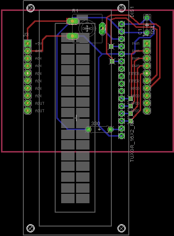

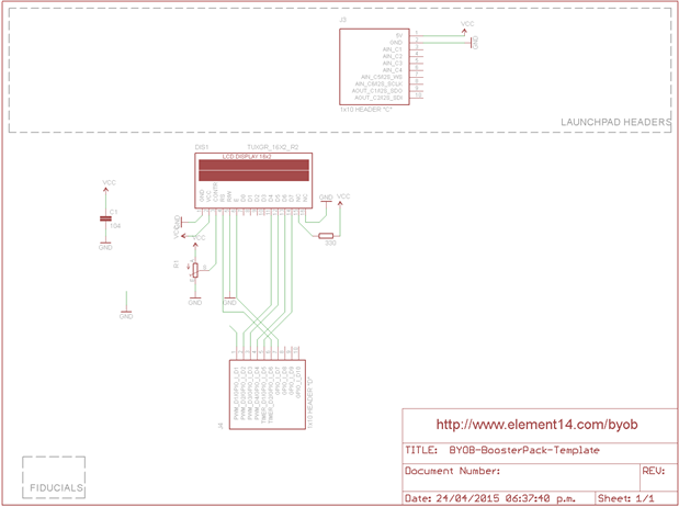

Schematic and BoosterPack
    Signal Conditioning
Signal Out
