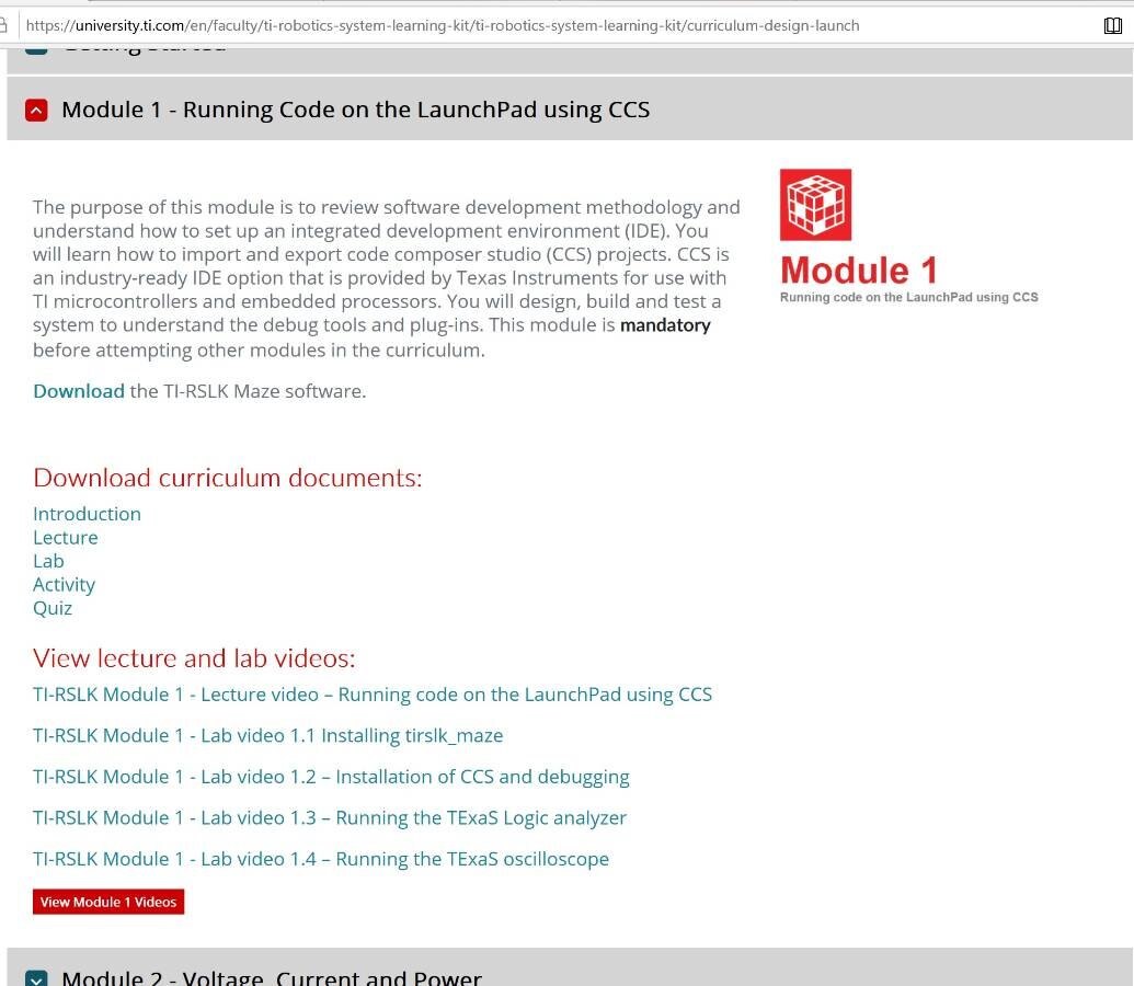

The curriculum has 20 modules, and the first 14 use the components that you receive in the basic kit. There is an additional module, called Robot Challenges, that brings together everything you learn to solve tasks related to line following and navigating through a maze.
There is a diagram on TI's website that shows the various pathways you can take through the curriculum and which modules to complete, depending on your focus. I decided to just work through them straight without skipping around.
The basic format for each module is that there's an Introduction, Lecture slides, a Lab PDF, Lecture and Lab videos, and then Activity and Quiz questions.
The curriculum on TI's website

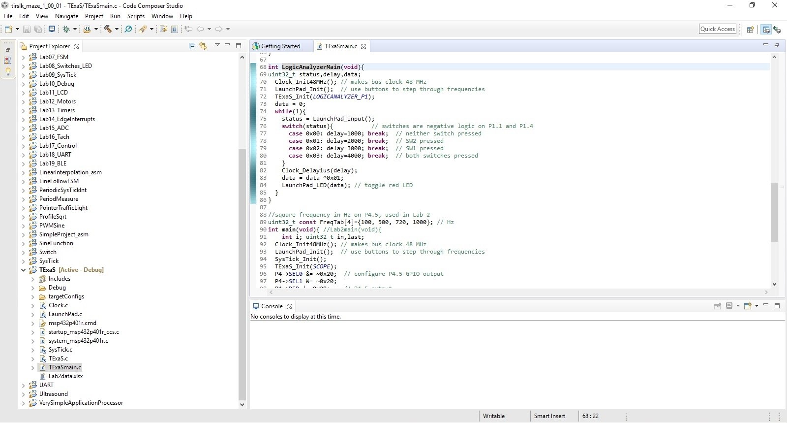

Module 1 begins by having you download and install Code Composer Studio (CCS) and the project code you'll be using. This took an hour and a half for me to do on my older PC. Next, you learn how to flash programs to the LaunchPad as well as debug by steppng through them, setting breakpoints and watching variables.
Lab 1.4.8 in Code Composer Studio

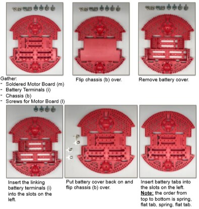

Steps 3 to 7 of the lab tell you to solder wires between the 2 boards. In the Construction Guide it has more sensible instructions, guiding you to solder headers onto the boards so that you can use jumper wires to make connections instead of soldering wires directly to the boards. You're also going to want to solder on Ground headers for the bump switches (highlighted in brown), as well as headers for the motors. Although it doesn't say to do this in the lab, it does say it in the Construction Guide, and if you don't do it now you'll have to remove the motor board later to do it.
     Page 7 of the Construction Guide
Steps 8 and 9 tell you how to arrange the battery terminals. Again, the Construction Guide has clearer instructions with pictures on page 9.
     Page 9 of the Construction Guide
