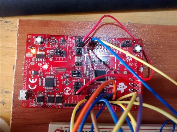

My goal with this app is to implement a control for low power motor (40Watt) to travez of a microcontroller CC3200 SimpleLink of the family Texas Instruments.
Simply send commands like "motor_on" to start the engine and "motor_off" to turn it off, making it as simple as possible for anyone familiar with the electronics.
CC3200 MQtt Control Motor

In this application, a graphical LCD screen is used, in which data such as name Network to the CC3200 Simple Link will connect, in my case is "casa1" is displayed once the platform has an answer modem that receives an address IP that is displayed on the LCD.

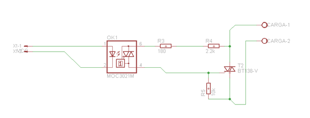

Power Circuit
-The power circuit as the name implies working on power, holding large current.
-An observation of this circuit is that energy is neither created nor destroyed so the question is not where the energy goes into the load, once made the cut.
-The answer is simple there is an element within this network that absorbs all that energy is not delivered and 2.2K resistor R4; This excess current is consumed.
-So this overheats, the application circuit resistances are 1 / 2w, but to see this little detail by a resistance R4 1W replaced.
To load control AC, I'm using a MOC3021, which allows me to control the flow of current to the motor, turning on a pin for programming the internal Led MOC is active and leaves circular AC on the other side, allowing the engine it lights; in the same way to switch off the control pin current is limited and the engine stops.
Schematic circuit solid state relay
Power elements
- General description
Triac on a plastic envelope, intended for use in applications requiring high capacity and bidirectional transient voltage blocking performance and high thermal cycling. Typical applications include motor control voltages domestic and industrial lighting, heating and static switching.
SymbolParametersMAXUNIT
VDRMState repetitive peak voltages500V
IT(RMS)RMS current on the state4A
ITSMNon-repetitive peak current on the status25A
The secret of programming:
Quite simply, the CC3200 to receive messages from this server PAHO internally generates an interrupt in the program, leendo the data buffer and storing it in a string.
The string is compared to the "strcmp" command, which already pre configured strings to be compared as "motor_on" and "motor_off" these handed me a value that then by a set of conditional "if", it switches to a the task to be performed.
