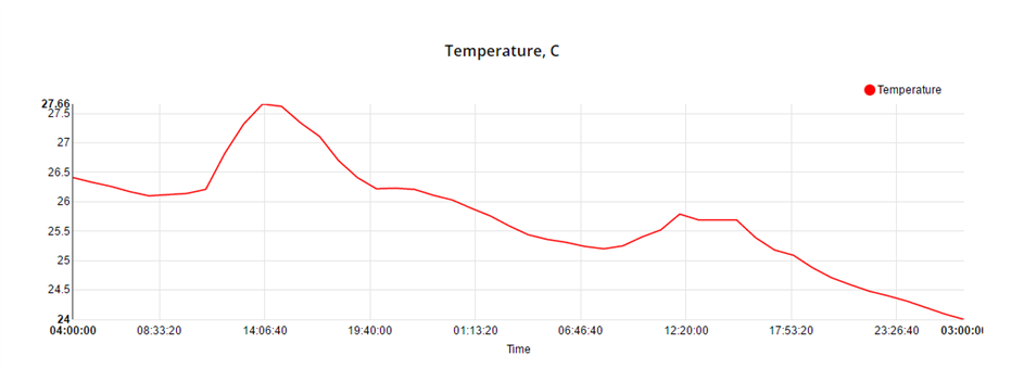

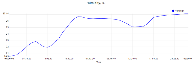

  • In this tutorial we used Tibbit #30 (ambient humidity and temperature meter) for collecting environmental data and storing it on the Keen.IO server.
  • A very simple in-browser application is used for fetching data from Keen.IO and displaying charts in the browser window (the charts below have been received from Keen.IO, they are not static).

   <h3>Temperature, C</h3>
   <nvd3 options="options" data="temperature">
   <h3>Humidity, %</h3>
   <nvd3 options="options" data="humidity">
