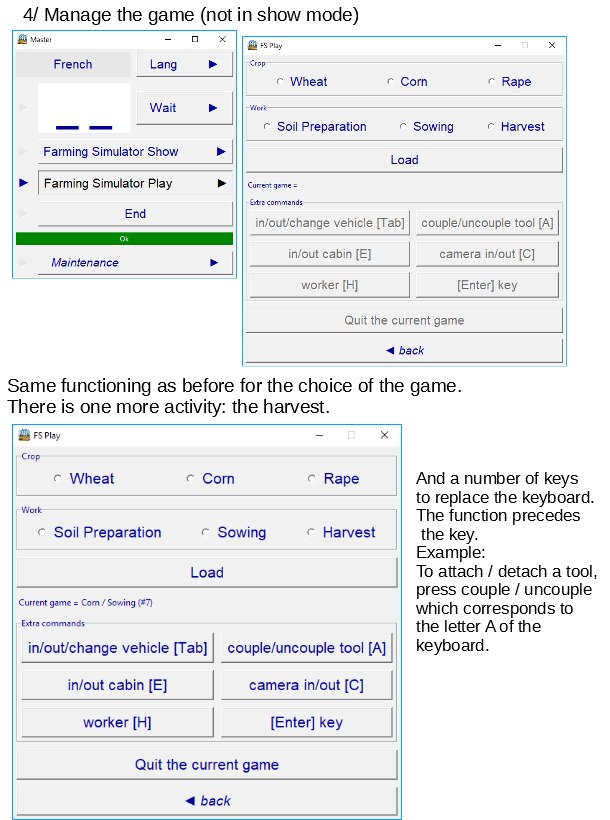

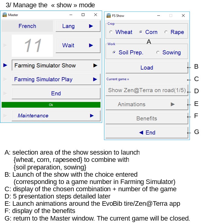

1/ FS_Hat
It's named "FS_HAT" as it will use the info coming from a, b, c described below to monitor the Farming Simulator 17 Software.
This PC is connected to:
a/ Arduino DUE native port, considered as a keyboard by the PC
b/ Arduino DUE USB (serial) link to exchange data between PC Left right arrow Arduino
c/ BU0836A that simulates a joystick

            # ----- enter game (career)
            sendSerial('kRET')

                        elif 'SKB' in cmd:
                            # ----- send to keyboard, SKB=
                            # keyA, keyE, keyH, key{letter},
                            # kTAB, kRET, kBKS, kESC ...
                            # relb, rstd
                            sendSerial(val)
                        elif 'Cmp' in cmd:
                            # ----- launch comparison
                            sendSerial('kBKS')
                            sendSerial('kTAB')
                            sendSerial('keyH')
                            sendSerial('kTAB')
                            sendSerial('keyH')

2/ "Show"
This PC is used for the SHOW.
When the animator is not presenting the tractor simulator, it plays some movies in loop (in movies directory) on the main screen. In the meantime, the tractor could be used as a simple simulator playing Farming Simulator.
When the animator switches to the presentation mode, it retreives the images from Farming Simulator (through the video grabber on USB3) and overlay texts, videos, messages on the main screen.
It overlays also the Zen@Terra app (same as the one on the Rasperry "Zen@Terra", Rpi_Pressure).
One can see the demo mode (with a speaker, see video1 ) and the play mode (guests can play with FS17, see video2, video3,).

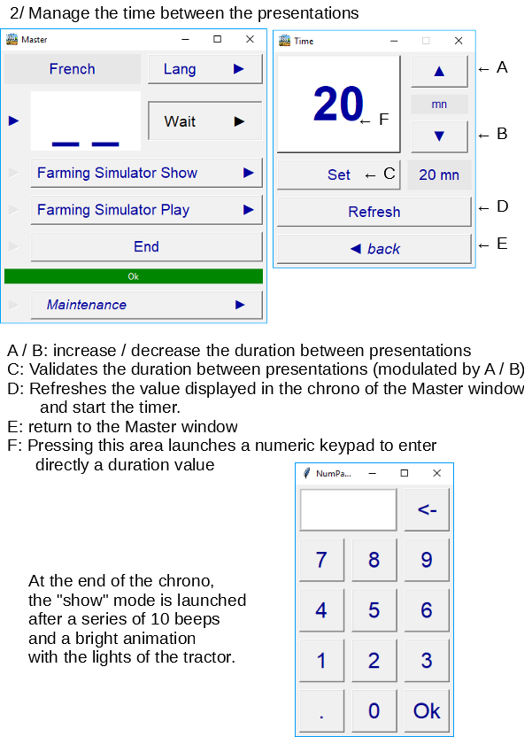

The main "Master" program, now, uses a numpad function to enter the time between presentations,
defNumpad.py_________________________________________________________________________
NUMPAD ===============================================================

        for i, t in enumerate(self.works):
            tk.Radiobutton(fr, text=t, variable=self.prep, \
                       value=i,  **fFmtn).grid(row=0, column=i,**gwdFmt)
        self.selRadio.append(fr)
        iRow += 1
        # ------- Load
        self.butLoad = tk.Button(self, text='Load', command=self.load, **fFmtn)
        self.butLoad.grid(row=iRow, column=0, **gwdFmt)
        # ------- reload
        self.fFmtr = fFmtn.copy()
        self.fFmtr.update(fg='darkred', \
                          font=tuple([int(3*v/4) if isinstance(v, int) else v \
                              for v in self.fFmtr['font']]+['italic']))
        iRow += 1
        # ------- curGame
        self.curGame = tk.StringVar()
        self.curGame.set('Current game =')
        tk.Label(self, textvariable=self.curGame, anchor=tk.W, fg=MiBlue)\
        iRow += 1
        # ------- next step
        self.stepTxt = tk.StringVar()
        self.stepTxt.set(ShowSteps[0] + '(1/5)')
        self.nextBut = tk.Button(self, textvariable=self.stepTxt, \
                                 state = tk.DISABLED, command=self.nextStep, **fFmtn)
        self.nextBut.grid(row=iRow, column=0, **gwdFmt)
        self.step=0
        iRow += 1
        # ------- Anim
        self.wAnim = tk.Button(self, text='Animations  \t►', state=tk.DISABLED, \
                                   command=self.dlgAnim, **fFmtn)
        self.wAnim.grid(row=iRow, column=0, columnspan=2,  **gwdFmt)
        iRow += 1
        # ------- Benef
        self.wBenef = tk.Button(self, text='Benefits', state=tk.DISABLED, \
                                command=self.dlgBenef, **fFmtn)
        self.wBenef.grid(row=iRow, column=0, columnspan=2,  **gwdFmt)
        iRow += 1
        # ------- Back
        tk.Button(self, text='◄ End', command=self.Quit, **fFmtn)\
        colrowconfig(self.winfo_children())
        self.update()
        self.dx, self.dy = [int(x.split('+')[0]) \
                            for x in self.geometry().split('x')]
        self.dx += dx
        self.curNGame = 0
        self.putData(['SUB', 'TirePos=2', 'Tcp2Ser'])
    def load(self):
        tCur = time()
        if tCur - self.T0l > 1: # avoid button "bouncing"
            self.T0l = tCur
            iPrep = self.prep.get()
            iCrop = self.crop.get()
            idx = iPrep + iCrop * 3
            ngame = 12 + idx
            self.curNGame = ngame
            if self.gameOn: self.end()
            self.putData(['SUB', 'Load={}&SKB=iOk0'.format(ngame), 'Fs_Hat'])
            self.curGame.set('Current game = {} / {} (#{})'\
                             .format(self.crops[iCrop], self.works[iPrep], \
                                        ngame))
            curTool = tools[iCrop][iPrep]
            self.putData(['SUB', 'Tool=' + curTool + '&Surf=road', 'Rpi_Pres'])
            self.putData(['SUB', 'ZaT=Tool:' + curTool + \
                             '&ZaT=Surf:road',  'Show'])
            self.gameOn = True
            self.nextBut.config(state=tk.NORMAL)
            self.curCrop = iCrop
            self.curPrep = iPrep
            self.butLoad.config(state=tk.DISABLED)
            for ws in self.selRadio:
                for w in ws.winfo_children(): w.config(state=tk.DISABLED)
            # vvvv - to delete when synchronized wint Fs_Hat - vvvvv
            self.setTimer(5000+ngame*10, self.enterGame)
    def enterGame(self):
        self.putData(['SUB', 'Sound=0',  'Tcp2Ser'])
        self.putData(['SUB', 'VLCPlay=begin_{}_{}.mp4'\
                            .format(self.curCrop+1, self.curPrep+1), 'Show'])
    def end(self):
        self.putData(['SUB', 'Tool=TRACTOR&Surf=road', 'Rpi_Pres'])
        self.putData(['SUB', 'Quit=1', 'Fs_Hat'])
        self.curGame.set('Current game = ')
        self.gameOn = False

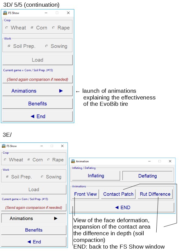

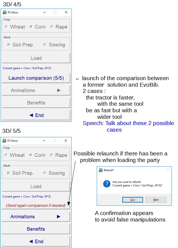

    def nextStep(self, ncrop=0):
        ShowSteps = ['Show Zen@Terra on road', \
                     'Start Tractor', \
                     'Go directly to field' , \
                     'Show Zen@Terra on field', \
                     'Launch comparison', \
        tCur = time()
        if tCur - self.T0n > 1: # avoid button "bouncing"
            self.T0n = tCur
            self.step += 1
            lST = len(ShowSteps)
            if self.step < lST:
                self.stepTxt.set(ShowSteps[self.step]+' ({}/{})'\
                                                      .format(self.step+1, lST-1))
                step = self.step
                iCrop = self.curCrop
                iPrep = self.curPrep
                if step == 1:
                    self.putData(['SUB', 'ZaT=Zoom:in', 'Show'])
                elif step == 2:
                    self.putData(['SUB', 'ZaT=Zoom:out' + \
                                         '&VLCPlay=start_{}_{}.mp4'\
                                  .format(iCrop+1, iPrep+1), 'Show'])
                elif step == 3:
                    self.putData(['SUB', 'VLCPlay=stop_{}_{}.mp4'\
                elif step == 4:
                elif step == 5:
                    self.putData(['SUB', 'ZaT=Zoom:out&OvlOn=1', 'Show'])
                    self.putData(['SUB', 'Sound=1',  'Tcp2Ser'])
                    self.putData(['SUB', 'Cmp=1',  'Fs_Hat'])
                    self.stepTxt.set('(Send again comparison if needed)')
                    self.wAnim.config(state=tk.NORMAL)
                    self.wBenef.config(state=tk.NORMAL)
                    self.nextBut.config(**self.fFmtr)
            else:
                if self.curNGame and QuestBox(title = 'Reload?', \
                            message = 'Are you sure to reload:\n{}?'\
                                              .format(self.curGame.get())):
                    self.putData(['SUB', 'Reload={}'.format(self.curNGame), \
                                  'Fs_Hat'])
                    self.nextBut.config(state=tk.DISABLED)
    # ===== ANIM
    def dlgAnim(self):
        if self.wAnim['relief'] == tk.RAISED:
            if not self.pannelOn:
                print('\t\t\t» Anims : {}'.format(strftime('%d/%m/%y %H:%M:%S')))
                self.wAnim.config(relief=tk.SUNKEN, fg='black')
                self.pannelOn = True
                AnimMan(self.icofile, self.putData, self.dx, int(self.dy*.3),  \
                                       self.fFmtn, self.gwdFmt, self.endAnim)
    def endAnim(self, adef):
        self.wAnim.config(relief=tk.RAISED, fg=MiBlue)
        adef.destroy()
        self.pannelOn = False
        print('\t\t\t« Anims : {}'.format(strftime('%d/%m/%y %H:%M:%S')))

class FSimuPlayMan(tk.Toplevel):
    def __init__(self, icofile, putData, dx, dy, fFmtn, gwdFmt, retfun):
        tk.Toplevel.__init__(self)
        self.resizable(width = False, height = False)
        self.title('FS Play')
        self.iconbitmap(icofile)
        self.protocol('WM_DELETE_WINDOW', self.Quit)
        self.transient()
        self.geometry('+{}+{}'.format(dx, round(dy/3)))
        self.putData = putData
        self.retfun = retfun
        self.gameOn = False
        butFmtC = dict(font = ('Arial', 14, 'italic'), fg=MiBlue)
        iRow = 0
        # ------- Crop
        fr = tk.LabelFrame(self, text='Crop', fg=MiBlue)
        fr.grid(row=iRow, column=0, **gwdFmt)
        self.crop = tk.IntVar()
        self.crop.set(0)
        self.crops = ['Wheat', 'Corn', 'Rape']
        for i, t in enumerate(self.crops):
            tk.Radiobutton(fr, text=t, variable=self.crop, \
                           value=i+1,  **fFmtn).grid(row=0, column=i, **gwdFmt)
        iRow += 1
        # ------- Work
        fr = tk.LabelFrame(self, text='Work', fg=MiBlue)
        self.prep = tk.IntVar()
        self.prep.set(0)
        self.works = ['Soil Preparation', 'Sowing', 'Harvest']
        iRow += 1
        # ------- Load
        tk.Button(self, text='Load', command=self.load, **fFmtn)\
        iRow += 1
        # ------- curGame
        iRow += 1
        # ------- extra buttons
        fr = tk.LabelFrame(self, text='Extra commands', fg=MiBlue)
        self.buts = [tk.Button(fr, text='in/out/change vehicle [Tab]', command=self.vehChg, \
                               state=tk.DISABLED, **fFmtn)]
        self.buts[-1].grid(row=0, column=0, **gwdFmt)
        self.buts.append(tk.Button(fr, text='couple/uncouple tool [A]', \
                                   command=self.couple, \
                                   state=tk.DISABLED, **fFmtn))
        self.buts[-1].grid(row=0, column=1, **gwdFmt)
        self.buts.append(tk.Button(fr, text='in/out cabin [E]', \
                                   command=self.inOutCabin, \
        self.buts[-1].grid(row=1, column=0, **gwdFmt)
        self.buts.append(tk.Button(fr, text='camera in/out [C]', \
                                   command=self.camera, \
        self.buts[-1].grid(row=1, column=1, **gwdFmt)
        self.buts.append(tk.Button(fr, text='worker [H]', \
                                   command=self.worker, \
        self.buts[-1].grid(row=2, column=0, **gwdFmt)
        self.buts.append(tk.Button(fr, text='[Enter] key', command=self.enterKey,
        self.buts[-1].grid(row=2, column=1, **gwdFmt)
        iRow += 1
        # ------- Quit game
        self.buts.append(tk.Button(self, text='Quit the current game', \
                                   state=tk.DISABLED, command=self.end, **fFmtn))
        self.buts[-1].grid(row=iRow, column=0, **gwdFmt)
        iRow += 1
        # ------- Back
        tk.Button(self, text='◄ back', command=self.Quit, **butFmtC)\
    def _resetSel(self):
        self.crop.set(0)
        self.prep.set(0)
    def load(self):
        iPrep = self.prep.get() - 1
        iCrop = self.crop.get() - 1
        if iPrep >= 0 and iCrop >= 0:
            ngame = 3 + idx
            self.putData(['SUB', 'Load_{}={}&SKB=iOk1'\
                                 .format(['N', 'H'][iPrep==2], ngame), 'Fs_Hat'])
                                     ngame))
            self.putData(['SUB', 'Tool=' + tools[iCrop][iPrep] + \
                                 '&Surf='+['field', 'road'][iPrep==2], \
                              'Rpi_Pres'])
            for b in self.buts: b.config(state=tk.NORMAL)
            self._resetSel()
            self.gameOn = True
    def vehChg(self):
        self.putData(['SUB', 'SKB=kTAB', 'Fs_Hat'])
    def couple(self):
        self.putData(['SUB', 'SKB=keyA', 'Fs_Hat'])
    def inOutCabin(self):
        self.putData(['SUB', 'SKB=keyE', 'Fs_Hat'])
    def camera(self):
        self.putData(['SUB', 'SKB=keyC', 'Fs_Hat'])
    def worker(self):
        self.putData(['SUB', 'SKB=keyH', 'Fs_Hat'])
    def enterKey(self):
        self.putData(['SUB', 'SKB=kRET', 'Fs_Hat'])
    def end(self):
        self.putData(['SUB', 'Boost=0&Manual=0&Tool=TRACTOR&Surf=road', \
                              'Rpi_Pres'])
        self.gameOn = False
        for b in self.buts: b.config(state=tk.DISABLED)
    def Quit(self):
        self.retfun(self)

class mainBoard():
    Main animation
    # ========================================================== initializing
    def __init__(self, qIn, qOut, config):
        # ======================= open graphic window, top screen, full screen
        fig = tk.Tk()
        #fig.overrideredirect(True)
        #fig.lift()
        fig.wm_attributes('-topmost', True)
        fig.geometry('+0+0')
        fig.iconbitmap(config.iconfile)
        fig.title('Master')
        fig.protocol('WM_DELETE_WINDOW', self.dlgEnd)
        fig.bind('q', self.Quit)
        fig.bind('Q', self.Quit)
        self.config = config
        self.getData = qIn.get_nowait
        # self.putData = print                       # <<<<< DEBUG
        self.putData = qOut.put_nowait
        # ------------------------------------------------------------ formats
        fs = 16
        self.fFmtn = dict(font=("Arial", fs), fg=MiBlue)
        self.fFmtb = dict(font=("Arial", fs, 'bold'), fg=MiBlue)
        self.fFmti = dict(font=("Arial", fs-2, 'italic'), fg=MiBlue)
        fs2 = 50
        self.fFmtc1 = dict(font=("Arial", fs2, 'bold'), fg=MiBlue)
        self.fFmtc2 = dict(font=("Arial", fs2, 'italic'), fg='blue')
        self.fFmtc3 = dict(font=("Arial", fs2), fg='darkgrey')
        self.fFmtc4 = dict(font=("Arial", fs2, 'italic'), fg='darkgrey')
        self.gwdFmt = dict(padx=5, pady=5, sticky='news')
        # ----------------------------------------------------------- variable
        self.nextShowTime = int(config['NEXT_SHOW']['nextshtime'])
        sLang = config['LANG']['lang']
        lglst = [lg[:2].lower() for lg in config.langList]
        iRow = 0
        # ---- line 1 : lang
        self.vLang = tk.StringVar()
        self.vLang.set(sLang)
        tk.Label(textvariable=self.vLang, bg=MiWht2, **self.fFmtn)\
                .grid(row=iRow, column=0, columnspan=2, **self.gwdFmt)
        self.wLang = tk.Button(text='Lang\t►', \
                               command=self.askLang, **self.fFmtn)
        self.wLang.grid(row=iRow, column=2, **self.gwdFmt)
        iRow += 1
        # ----- Counter                                             (STEP#0)
        self.wStep = [tk.Label(text='►', disabledforeground=MiWht2 , \
                                   **self.fFmtn)]
        self.wStep[-1].grid(row=iRow+1, column=0, **self.gwdFmt)
        self.vCnt = tk.StringVar()
        self.vCnt.set('_ _')
        self.wCnt = [tk.Label(textvariable=self.vCnt, width = 3, \
                              bg=MiWht1, **self.fFmtc1)]
        self.wCnt[-1].grid(row=iRow, column=1, rowspan=3, **self.gwdFmt)
        self.wCnt.append(tk.Button(text='Wait\t►', \
                              command=self.askTime, **self.fFmtn))
        iRow += 1
        self.wCnt[-1].grid(row=iRow, column=2, **self.gwdFmt)
        iRow += 2
        # ----- Farming Simulator Show                              (STEP#1)
        self.wStep.append(tk.Label(text='►', disabledforeground=MiWht2 , \
                                   **self.fFmtn))
        self.wStep[-1].grid(row=iRow, column=0, **self.gwdFmt)
        self.wFSimuS = tk.Button(text='Farming Simulator Show\t►', \
                               command=self.dlgFSimuShow, **self.fFmtn)
        self.wFSimuS.grid(row=iRow, column=1, columnspan=2,  **self.gwdFmt)
        iRow += 1
        # ----- Farming Simulator Play                              (STEP#2)
                                   **self.fFmtn))
        self.wFSimuP = tk.Button(text='Farming Simulator Play\t►', \
                               command=self.dlgFSimuPlay, **self.fFmtn)
        self.wFSimuP.grid(row=iRow, column=1, columnspan=2,  **self.gwdFmt)
        iRow += 1
        # ----- end                                                 (STEP#3)
                                   **self.fFmtn))
        self.wEnd = tk.Button(text='End', command=self.dlgEnd, **self.fFmtn)
        self.wEnd.grid(row=iRow, column=1, columnspan=2, **self.gwdFmt)
        iRow += 1
        # ----- status
        self.vStatus = tk.StringVar()
        self.vStatus.set('Ok')
        self.wStatus = tk.Label(textvariable=self.vStatus, \
                                bg='green', fg='white')
        self.wStatus.grid(row=iRow, column=0, columnspan=3, **self.gwdFmt)
        iRow += 1
        # ----- maintenance                                         (STEP#4)
                                   **self.fFmtn))
        self.wMnt = tk.Button(text='Maintenance\t\t►', \
                              command=self.dlgMnt, **self.fFmti)
        self.wMnt.grid(row=iRow, column=1, columnspan=2, **self.gwdFmt)
        fig.update()
                            for x in fig.geometry().split('x')]
        # ----- pannels
        self.panLang = None
        self.panTime = None
        self.tiCnt = None
        self.CountFlag = 0
        self.mnsec = 'mn'
        self.mnsec2 = 'sec'
        self.cntTime = 0
        self.step = 0
        self.setState(0)
        self.panFSimuShow = None
        self.panFSimuPlay = None
        self.panMnt = None
        self.RpiOn = [True]*4
        self.enterGameFlag = tk.IntVar()
        self.icofile = config.iconfile
        self.mainloop = fig.mainloop
        self.destroy = fig.destroy
        self.setTimer = fig.after
        self.fig = fig
        colrowconfig(self.fig.winfo_children())
        self.fig.after(10, self.wait4action)
        self.mainloop()
